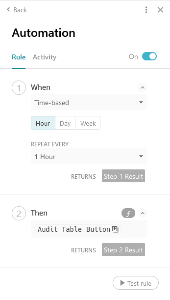

As a workaround you can add a button column in your Audit Table that adds to the History and updates the row, you can disable the button if Diff is Blank and set the automation to press the buttons in the table.
I copied your doc and tried this approach and it worked as expected.
And the automation it set up like this:
This bug should be fixed! But let me know if you’re still seeing it.
