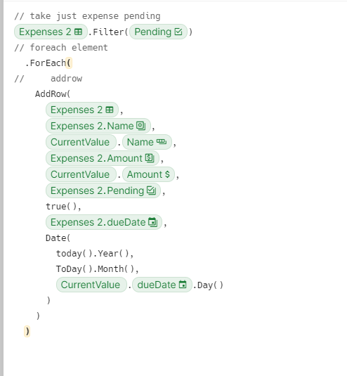

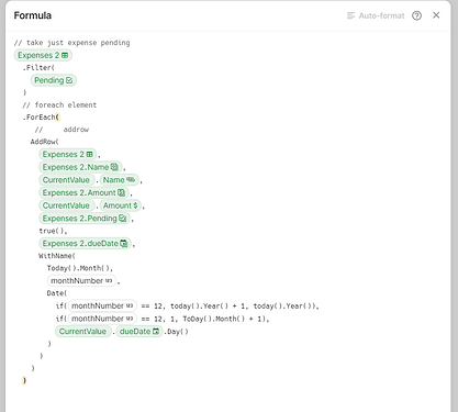

Hello, I propose a solution on your doc.
I have unstructured the steps.
→ one button per row to perform the duplicate action and +1month
→ a checkbox to indicate where the button will be activated (dynamic formula)
the checkbox is not based on the nextDate column.
It retrieves the row with the same name and the latest date and compares it with the current row.
→ a general button to retrieve the rows with the true checkbox and click on the buttons.

i can select my to-be-copied dataset nicely - the filter works great. i can even create a FormulaMap and modify the dates in the copied dataset to the next month - but i can’t seem to figure out how to put them back into the fields one-at-a-time.
is there a method within the context of duplicating a set of rows to iterate the copied set, read the value of a column for each row, and modify that value?
so i currently have a button that marks the items in the current month as pending, and another button, using the code you added to copy just those items.
i suspect i could avoid that first step and, instead create a filter that selects just the items for this month and then uses the AddRow to “copy” them to next month.
