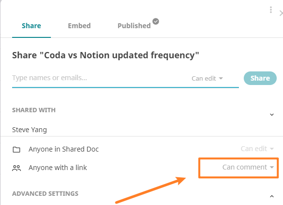

How do you make doc public without requiring guest to ask for permission to accesss the doc ?
I only know how to give access only when i know the person’s email address
Apologies @Steve_Yang

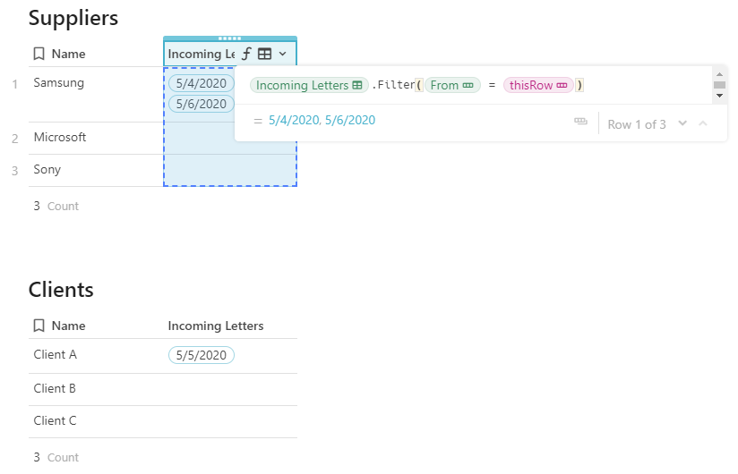

However, if it’s simply to keep a link and perhaps do some aggregation back into clients/suppliers, this will work just fine as is. Aggregation would still work with no workarounds:
