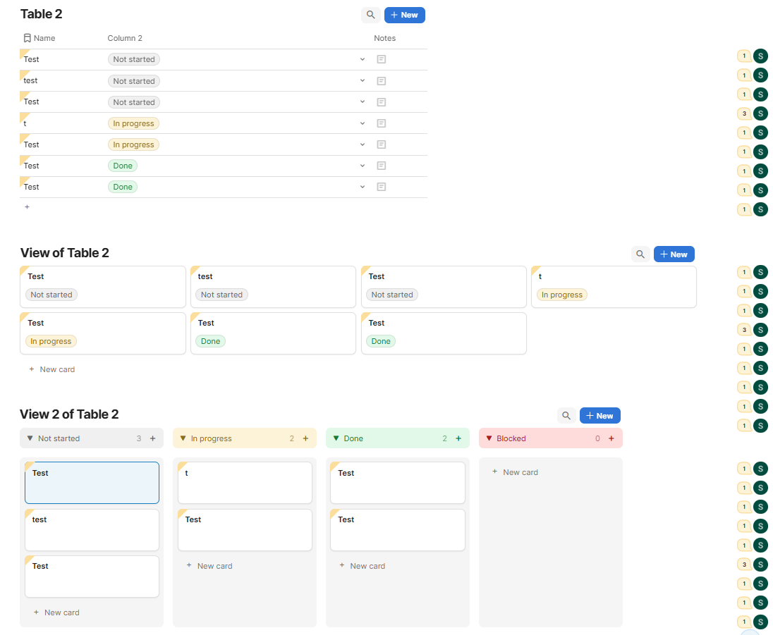

Hello! I’m worried I’m not going to be able to convince my company to use Coda due to how comment appear overwhelming on main views.
Comments appear on the right side as well as a yellow tab on the left side of any row item like a table row or card or what not. I get the idea but this looks insane when every single item has a comment- especially if you are using multiple views of the same table. Often times my team in their projects will leave comments like status updates which works much better than notes because it automatically notes the user and date. We wouldn’t want to resolve these comments because then they would be hidden. Plus, what would I do, tell my team, make a comment then resolve it yourself immediately if you don’t need anyone else on it?
The only option I see is to hide comments at the top right which then removes comments from both the main page and the layout page at which point you can see comments but only if you open the layout view then click “Activities” which seems like a lot of extra steps.
This is the only thing I think I won’t be able to convince my company to get over because it looks so messy. Any insights on this?

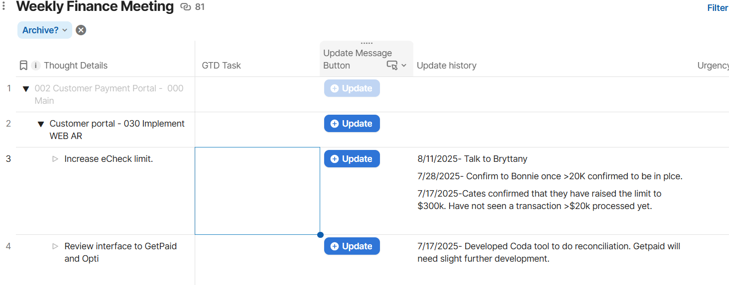

I follow a system very similar to that of Max for my todo-list with my business users. I had a comments column, but on some long running topics, it got to big.
So I created a button with the code as shown below. I prefix the comment with the day’s date and a dash, you could easily include user() in the concatenate:
The Comments column has a formula that displays the three most recent comments like such:
And the end result looks like this:
There has been no need so far, but it would be very easy to add a Resolved checkbox and use that to exclude comments. I currently only use this in one table, should be similarly easy to expend the db Update Messages table to include messages from multiple table.
