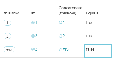

Hi All,
I’ve been stumped on this one. Anyone have any idea???
The goal is to transform an @Reference so it will match thisRow.

@ref in a cell differs from =@ref in a cell.
It’s easiest to see examples. Review the formulas in this doc.
Hey @Shaun_McLean1, welcome to the Community!
Both the “bubble” and the “@-reference” are row references. The key difference is that:
  • The bubble is how Coda displays a row reference on its own or in a list.
  • The @-reference is how Coda displays it within a rich text.
So, the left one is a reference on its own (and don’t let the Text column type fool you — the Text column type works as “any type” in Coda and does not convert items to text, but rather will try to auto-guess the type and render that). And the right one is a single line of text with a span that resolves to a row reference.
That’s why the two (the reference and the formatted text with a reference as its only content) are not equal.
I don’t have a ready solution to extract a row reference from the rich text column (although I believe it’s possible). What you can do instead is the opposite — construct the rich text that would equal to the text on the right. To do this, simply:
Concatenate(thisRow)
and you’ll get the same text that you’ll be able to compare to AtRow on the right.

Let this be an illustration to what I explained earlier (refs vs rich text with refs) :slight_smile:

You truly are a champion. Thank you. Quite frankly, the initial solution you provided with Concatenate(thisRow) worked well enough :D.
