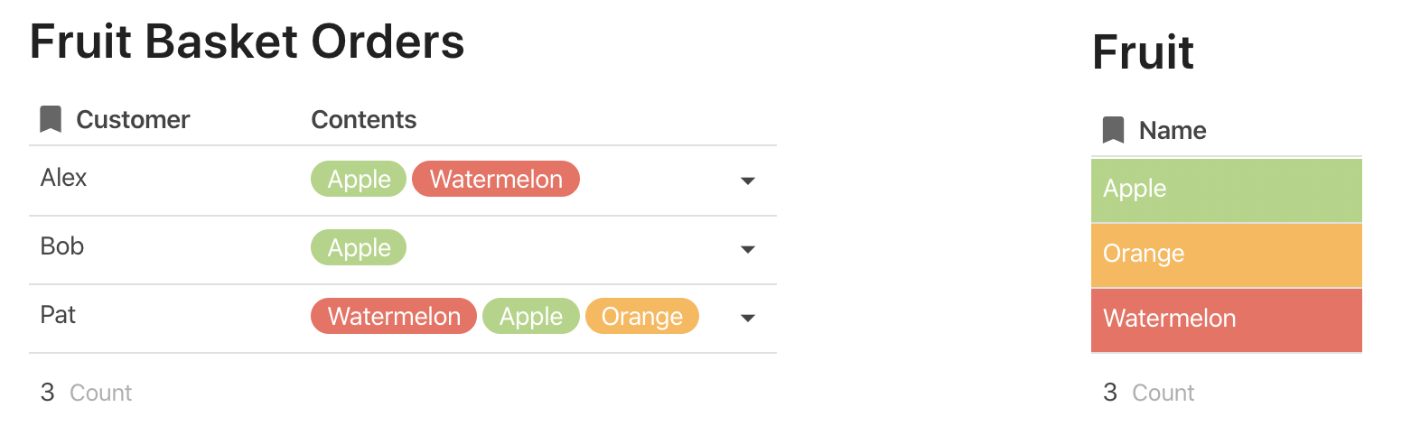

I am trying to figure out how to carry over conditional formatting between tables in the same doc. When one table is a view of the other, the conditional formatting carries over, which is great. But if the tables are not linked, I cannot find a way to either 1) pull the conditional formatting over when referencing the other table via Lookup or otherwise, or 2) batch copy and paste the formatting rules. Example below:
Conditional%20Formatting
In the above example, I cannot figure out a way to pull the formatting from the table Team into the table Favorites if they are not linked (Select list, Lookup, Filters, other formulas, etc. have not worked). I also cannot easily copy and paste the formatting rules. For clarity, formatting in this case references the coloring, since certain basic formatting can be done in other ways (e.g. italicizing).
If I do make Favorites a view of Team, I run into limitations with formatting if the data is repeated. For example, if the above Favorites table was made like this:
I would want each team formatted at the cell level. The only solution I found is to repeat the conditional formatting rules with each repeated set of rules only applying to one column. This makes it possible, but quite tedious if you have a large number of conditional formats.
Related, I am relying on conditional formatting since the table color options for text and background are currently limited compared to conditional formatting coloring options.

Conditional formatting set in a main table can be inherited by all views, but there isn’t a way to connect two disconnected tables for formatting only.

But just in case this wasn’t the problem, another way to apply a conditional format is to use another table and a lookup :blush:.
I create a table I called Ratings and did the conditional formatting on this table (one time only). It is linked to the table (I called) Parameters using a LookUp fields which carry over the conditional formatting :blush: .
It doesn’t look exactly like your screenshot but it might be a way to work around your problem, maybe ? :innocent:

Since Coda supports conditional formatting in lookups, this seems to be a proper workaround.
