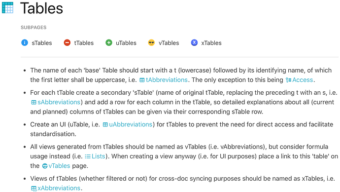

Edit2: I’ve created 3 docs to demonstrate the case:
