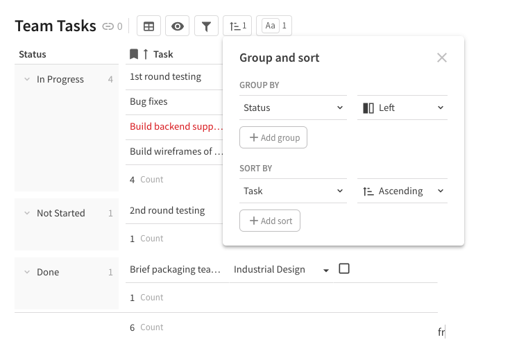

Is there a way to keep the Rank ID ascending ordered even if you move rows around in the table?
Yes Jonas please use rank column as a column for sort.
That will not cut it as I don’t want the rest of the table to be re-sorted. I need a way to reference the previous row in a table and was hoping to use your Rank formula to create a row index I can reference, but I need to have it always stay absolute top to bottom, independent of if the user sorts the table or repositions rows. Not sure if I make my self clear, but let me know if you can think of another option

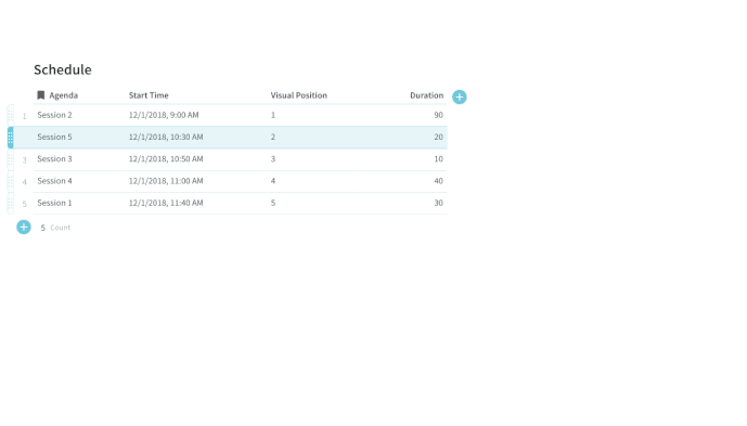

I’m building an agenda for a workshop and want to achieve the same result as in this thread Cumulative Start Times for Event Schedule. The user would set the start time and then set duration per activity (row). The formula I need is to populate a Start Time column automatically for each activity (row) calculated on start time + duration of all previous activities (rows). The formula in linked thread above works as a solution, until the user moves a row to a new position in the table.

Here is a link to the Excel file I’m trying to redo in Coda. It needs to be open in Excel to work as intended. As you will be able to see, the formula in A5-A19 automatically calculates correct start time based on previous rows start time and duration and the start time will continue stay correct if you move a row up or down. Can you think of a way to reproduce this in coda?
https://drive.google.com/file/d/1vi3ty8vjQId9U3G82wIvvino0xuM9BlO/view?usp=sharing
Thanks Jonas for sharing Excel - I understand what you are trying to do now. Here’s a post I made to find visual position of the record as I think it would help others as well -
I think it should be straight forward for you to update start time now that you know visual position. :slight_smile:

here’s a document in case if you want to take a look.
Thanks for this. It solved my problem and here’s a version of my final doc https://coda.io/d/Team-Train-Agenda_dddMwh-c5Fi/Agenda_suebT#_luDKo
