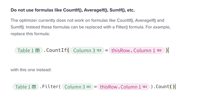

Ok so, one thing I can tell you is that on the long term, it is better to avoid the use of CountIf() if you can :blush: (as it’s better to build a doc to avoid performance issues from the start than having to optimize formulas later IMHO :innocent: )
Source of the screenshot: Somewhere in :point_right: Optimizing slow formulas in your doc | Coda Help Center :blush:
