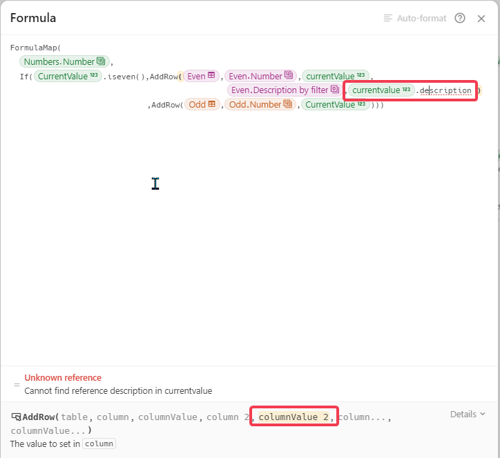

I am trying out FormulaMap() and CurrentValue to get a better understanding.
My setup is like this: A table with numbers 1 to 5 in a column, and descriptions One to Five in a second column.
Then I use a button with formulaMap and AddRow to copy Odd number to a table called Odd, and Even numbers to a table called Even.
I have it working for the display column, but I am not getting the second column added to the AddRow formula.
Can Somebody please help?

That’s because you are iterating on Numbers.Number and not directly on Number. So FormulaMap is looping over each number from each row but not the whole row, and thus CurrentValue represents the current number and not the current row, so you don’t have access to the Description column.
Your formula should start with :
FormulaMap(Numbers ………
You can then access the current number via CurrentValue.Number and the description via CurrentValue.Description. Or simply typing Number and Description.
Wonderful!
Got it.
Thanks

its hard to see it. but the clue is the tiny 123 icon on the CurrentValue - that shows that it is a single numeric value.
my retina seems to effeciently filter out all those little icons that the codans went to so much trouple to provide. but whenever i have unexpected results, i put on my stronger glasses and look closely at those icons and they usually add lots more information about what coda thinks is going on.
