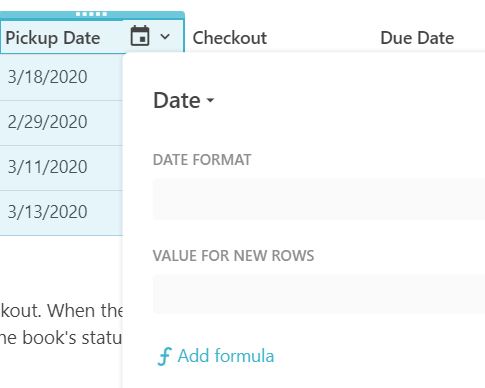

My Pickup Date column is auto filling random dates. It wasn’t doing this before, but it suddenly appeared. This causes my Due Date field to auto-populate too since it’s set to add 42 days to whatever is in the Pickup Date field.
I can add a formula to have it set the pickup date to today as soon as the Check Out To field is entered. But I want the flexibility to be able to say that an item can be checked out on another day – just not today. If I try to get the field to go blank, I then lose the ability to click within the cell and get the popup calendar.
![Capture](https://global.discourse-cdn.com/business6/uploads/coda1/original/2X/2/23205e5d4b5b341b344a695530bf0716477a7ef2.jpeg)
The view below shows there’s no formula for the Pickup Date column.
![Capture](https://global.discourse-cdn.com/business6/uploads/coda1/original/2X/2/29f0a98fe9a3f439bbb7f65a884048c1dba99d56.jpeg)

Hello, @Jean_Pierre_Traets! When I started building the demo, the problem reappeared immediately when I added my due date column. The formula is Pickup Date + Days(42). As soon as I typed that in, I got 2/10/1900 in each row. I didn’t even finish setting up the checkout demo since the error showed up so quickly.
I don’t recall it doing this originally (before I began adding other features to my checkout process).

You’re right! It works as soon as there is a pickup date selected. It just looks funny that when there isn’t a pickup date it shows a (seemingly) random return date. I’m building this out for my colleague who is less tech-savvy and I suspect it’ll bother her to see that random date sitting there.
Hello @agoodman! you could add an If statement so it doesn’t show anything when Pickup Date is blank
If(thisRow.[Pickup Date].IsBlank(),"",thisRow.[Pickup Date]+Days(42))
