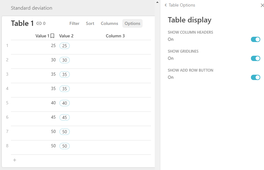

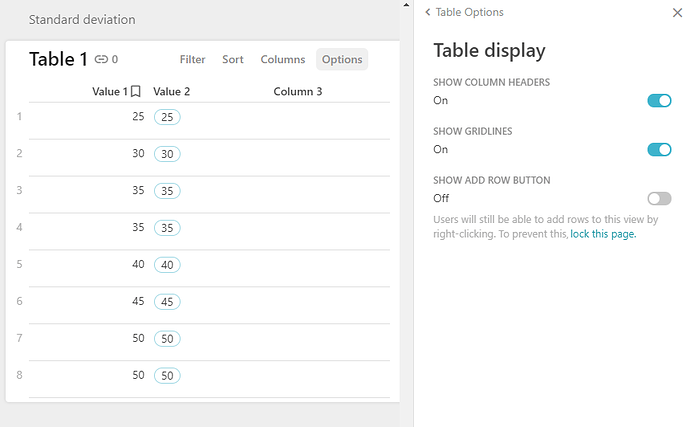

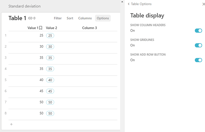

How do you disable the plus signal for adding new rows?
