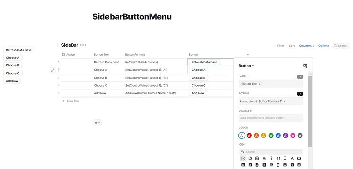

You can also make buttons directly dynamic by using formulas
But in my docs I everywhere go with the direction of @Quentin_Morel to also have different colors and icons and place multiple buttons in column. You can still use “if” to show/not show buttons or simply use the disbaledIf field in the button to gray it out.

@colm.toolan canvas column is a great way to that, and you can even show the buttons in the table view if you activate “Display preview”. For a multistep process like a workshop, this is most likely the best solution.
But just for the records, it is also possible with the buttons formula, which is helpful if you have 1000s of rows and want to show a button based on a condition - and not manually create a button via canvas column. E.g. I use this in a shared task list, where I the person who is doing the task clicks on “done” and the supervisor clicks on “sign-off”, both in the same column.
2022-08-10 16.23.57
Here is an example of how to do this:
@Quentin_Morel yeah, you can not enter a formula as a text in a table and use it as a formula or action somehwere else. You can only do it the way you are aware of: create a column for each button instead of creating a row. In the end its almost the same effort and you can hide the many columns afterwards.
