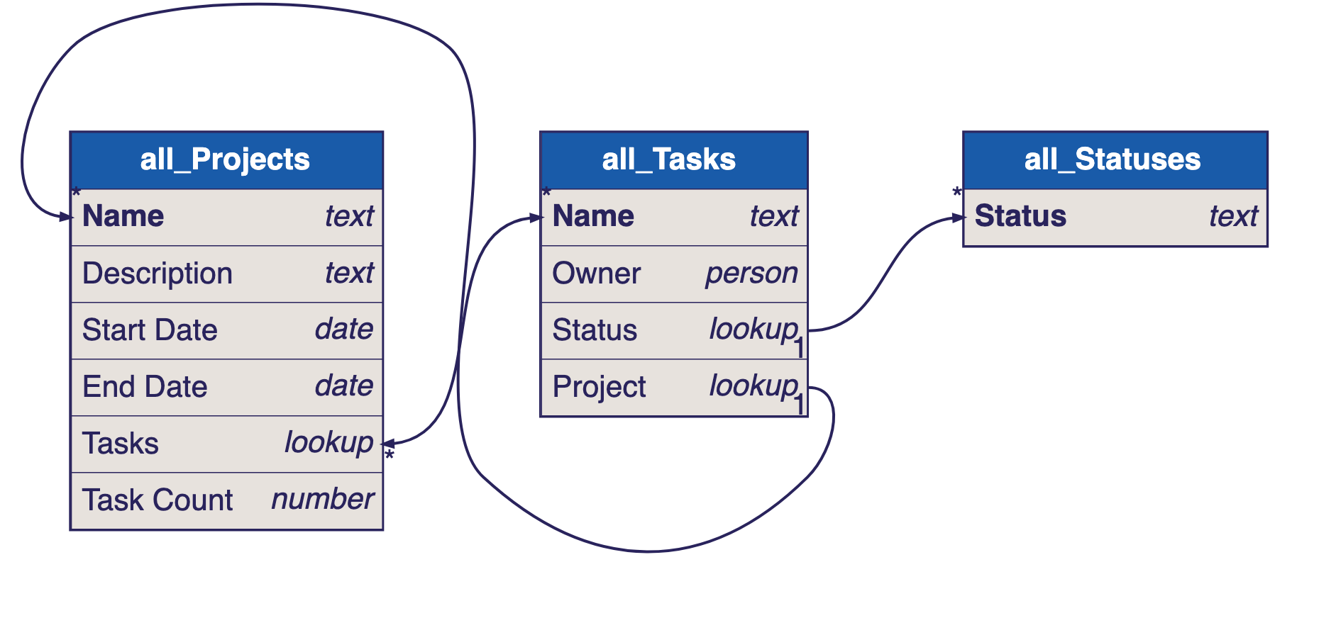

  • a visual tables relationship structure (both as a PNG or with the ability to play with an embedded dbdiagram.io, similarly as in @Scott_Collier-Weir’s provided pack) with the possibility to include/exclude tables based on your own criteria.

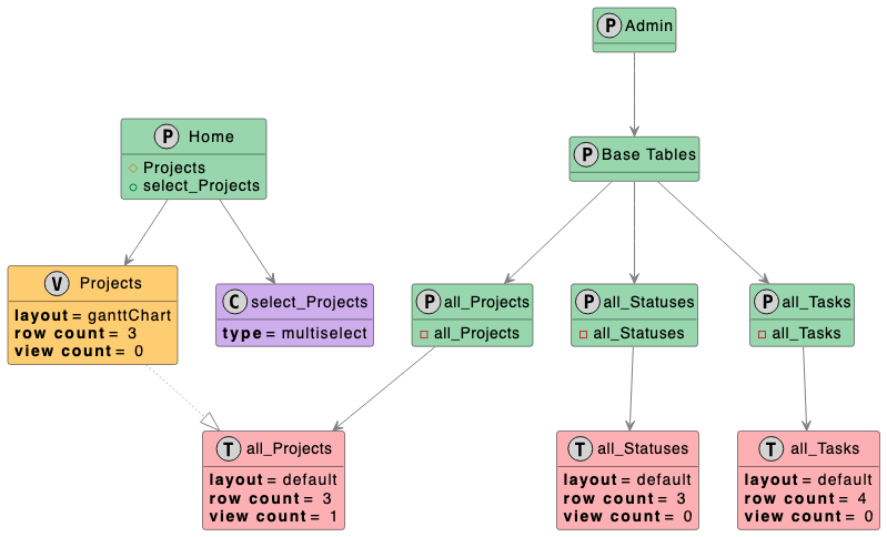

  • a visual pages structure along with their contents (tables, views, formulas and controls), fully customizable (choosing what components to show and excluding attributes, subpages, etc)

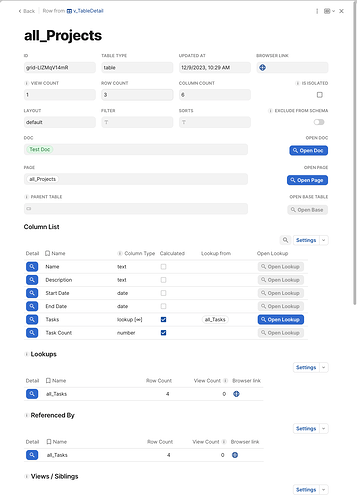

  • a fully browsable structure - and partially content - of any document (rows are excluded, for the moment), via connected sync tables. Meaning that you’ll have a detailed view for each block (page, table, view, column, formula, control), with the ability to browse the hierarchy of components without opening the source doc. Or opening the source doc exactly where that component resides.

Is it possible to hide columns from the generated table schema? If not, could you add that as a feature request?
I have a large document I’m working with (60-70 tables), and I want to focus on the connections between them (lookup columns only) to reduce the noise.

Hi @Chris_Williams,
Yes, it makes sense: I’ll put it in the todo list.
In the meantime, I’d suggest to use the embedded dbdiagram editor, so that you can freely (manually) adjust your data according to your needs.
Cheers!
Hi @Chris_Williams,
I added that functionality :+1:
Please, keep in mind that in order to keep some formal consistency, there are some… workarounds.
e.g. there are no primary keys on Coda tables (or better, there are internal RowID, but it might lead to confusion), so I simply assumed that display columns act as primary keys, which is kind of forced, but intuitive.
I also changed the syntax generation strategy for both tables and pages.
Now you should not receive any Coda error when dealing with huge schemas.

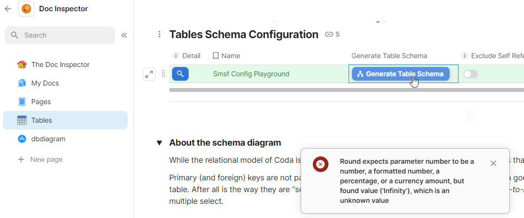

Hi @Federico.Stefanato, this is exactly what I need but after strictly following the instructions I get the following error. Don’t want to make the doc public because it would expose too much data, but would you mind if I share it with you?

Digging into this problem with @Pablo_Duart, I realized there was a small issue with a slider control.
It’s now fixed (v.1.3.1) and I suggest to always take a look at the latest published document.
In case anyone of you is also experiencing a rounding error when generating diagrams, please, be sure you have the slider_CellMaxLength control (Admin/Variables page) set to 43.000. Or, in any case, a value higher than 0.
Thank you for your support Federico! it is indeed working now as expected
