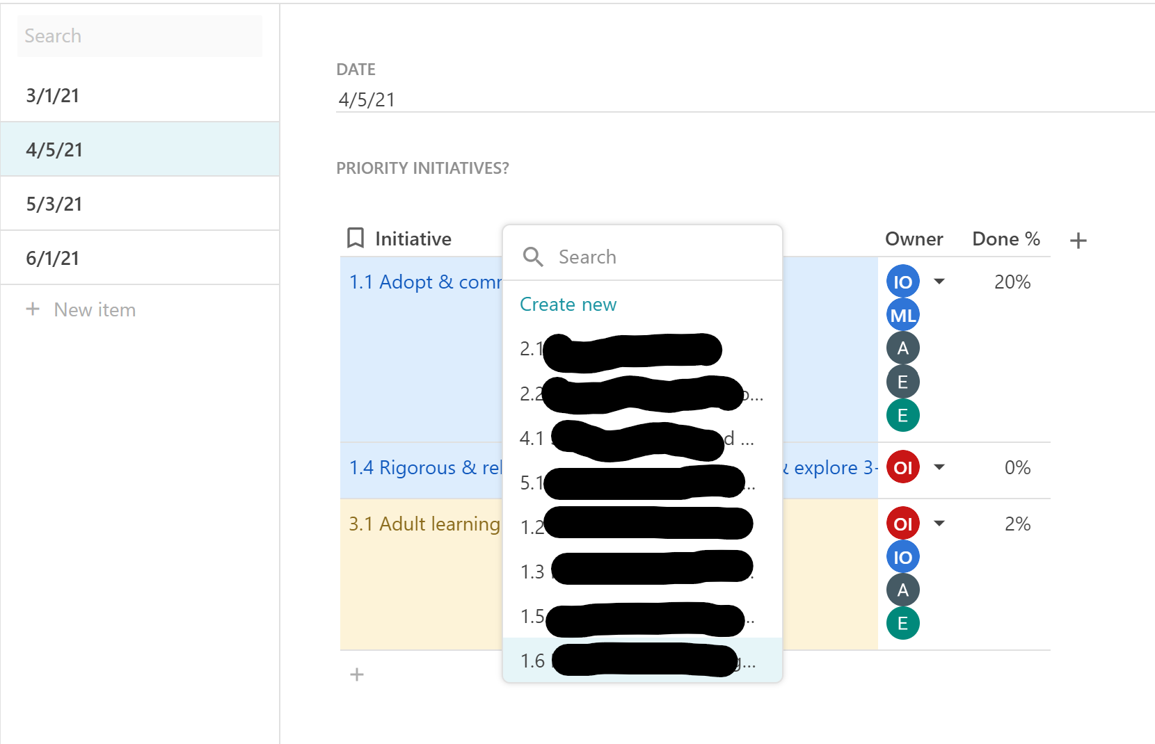

I’m trying to create a table (“Summary”) that allows users to select a list of “Priority Initiatives” from another table (“Initiatives”). Each initiative has 1+ owners, a status, and other attributes. I want to display the Summary Table in detail view and then have the Priority Initiatives show as an embedded table that includes columns for the Initiative, owner, due date, etc. So the embedded Priority Initiatives table would show one initiative/row. When users add rows they can select the priority from a drop down. It works well implemented as a lookup, but the dropdown is not in order.
Using a select list works to sort the order of the drop down, but I don’t see how I can set up the table within a table view this way?
Can anyone help me set this up so I can have the display look like the first screenshot but with the dropdown list sorted?
