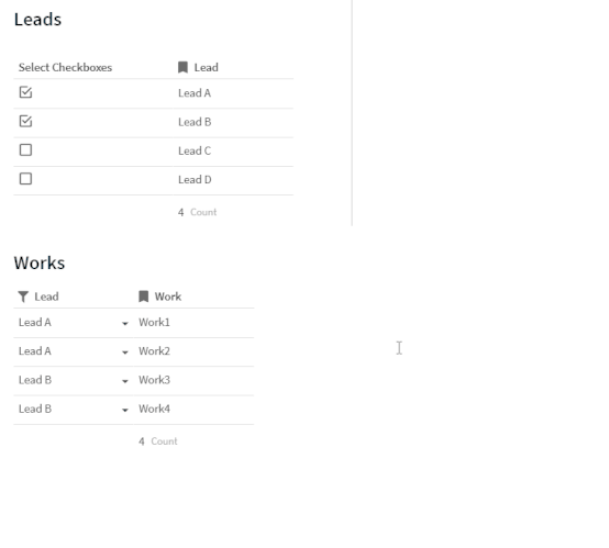

Ok, so maybe something like this will do the job well enough for you at least for now.
It’s a very simple setup where just a checkbox column inside the parent table is being used and a filter formula inside the child table. The only drawback is that you have to uncheck the selection afterwards.
Filter formula:
Leads.Filter(Lead=thisRow.Lead).[Select Checkboxes] = true
Thanks Kris. This is a good workaround until the feature is incorporated.
