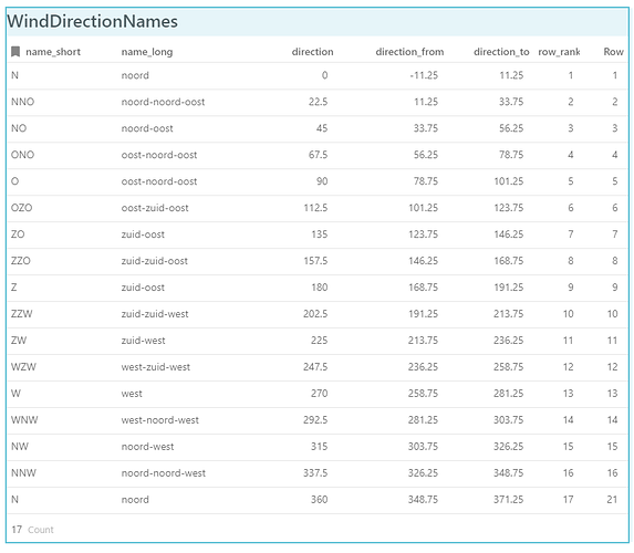

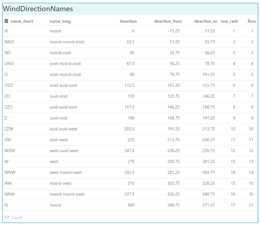

I am struggling with the following: I have a named formula ('actual_wind_direction)
I have a table called WindDirectionNames with, among others, the columns name_short and direction_to.
I am trying to retun (to a text area) the short name value from the row that holds the next larger value that I am passing to the formula (i.e. actual_wind_direction = 23, it should return ‘NNO’
Anyone any ideas? In Excel I would use vlookup with the TRUE option, but I not getting it to work in Coda. The part that I am not getting to work is the equivalent of TRUE option - exact values are being found with Lookup(), but not the in between values.
Hi
If I understand what you are looking for, maybe this formula will help:
[WindDirectionNames].filter([direction_to]>'actual_wind_direction').min().[name_short]
This should filter the table for the rows where the value of the direction_to column is larger than the value of the ‘actual_wind_direction’ formula, then take the row with the minimal value and return the value of the name_short column in that row.
Hello Asaf_Dafna - thank you. This is one solution to get me the result I needed - I tweaked it a little bit and came up with:
WindDirectionNames.filter(direction_to > actuele_windrichting and direction_from < actuele_windrichting)
