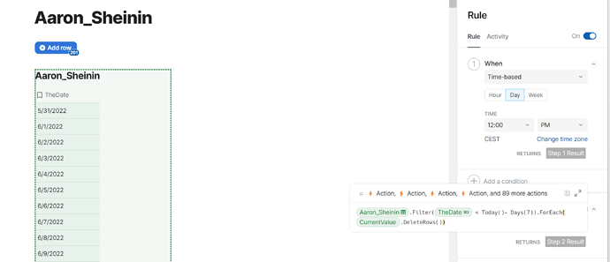

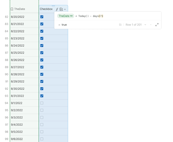

hi @Aaron_Sheinin , welcome to the community. It is very well understandable that you don’t see it directly.
I see two options: you have an automation that deletes only boxes checked and how to check a box, see below:
the second option is to integrate the function as filter in your automation like below, you don’t need the check boxes in this approach.
hope it helps, Christiaan

So, Christian, first thanks. Second, on the second option – is that just a two-step automation?
yes @Aaron_Sheinin
in step one you define the time : every day at a certain time
in step two you enter the code as written and you replace TheDate with the name of your column.
there is no condition, thus indeed two steps.
once you try and it does not work for you, please let me know
cheers, christiaan
Awesome. That makes me think the third step was probably causing the error. I’ll test it and let you know. I thought it was requiring me to create a third step.

Christiaan, your version did work, although it didn’t seem to do anything. So added this as Step 3 and it did work. Thank you so much for all your help.
Step 3: [Publish date]< Today()-Days(7)
