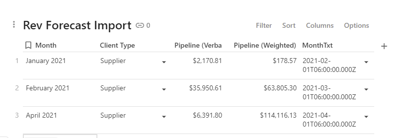

@Al_Chen_Coda I just noticed that I’m having a similar error with the calculation field in the Coda sync table not updating. The problem is that I’m pulling in the data from a dynamic source table. So when January went away in my source table the formula is still showing it in the sync table in Coda even though the MonthTxt field is showing February (it’s the same Coda_Source row in the source table which was originally January).
Can you share some screenshots of the error you are seeing?
No problem. Please see below. This was workng a couple of hours ago and it looks like an update was made to the source data and it’s out of sync again.
Realized it’s only Jan & February that are wrong
Here’s my source table (latest changes haven’t synced yet)

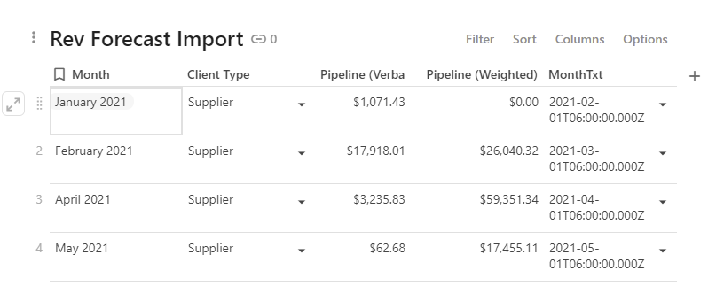

After sync, same issue:
@Al_Chen_Coda I fixed my problem. I added a new column in my source table that converted the date to txt. When that came through Coda recognized it as date so I could use it as my Month column w/o a formula in Coda. I also changed the option to resync the full table each time to deal with the changing rows. Thanks for the help
