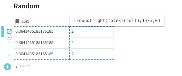

To even make a game possible, I needed a way to have some kind of “random” odds of winning. I thought, at a goalshooting game, a chance of 1:3 would be good.
But how can you make a game mechanism, when you don’t have “randomize” function?
As an inspiration, I found some articles about pseudorandom formulas. It seemed to be possible to generate such things with timestamps. But since there is no timestamp in Coda, I need to use the seconds of the now() formula.
To get my “1 of 3” odds, I created a table with 60 rows. Each Row represend a second of a minute. I filled them with my numbers 1-2-3-1-2-3-1-2-3-1-2-3… All I needed to do now is a formula, that selects the number by the row of the current second. That is not really “random”, it is just a fixed 1:3 chance every second - but enough for the current state of the game.

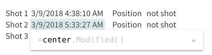

I used the checkbox as my trigger and counted the seconds after that. This was my countdown. Every second, the ball should move 1 field further and at second 4, the game should decide if you win or loose.
Counting the seconds (click to expand)
Checking, when the checkboxes are modified last:
(Shot 1 Shot 2 Shot 3 represent the time a shot was made from left, center or right)

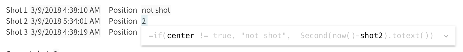

If one of the checkboxes is checked, the counter starts to count the seconds (=the position of the ball):
While the seconds now represent the position on the “field” (1 second after click: 1st position, 2 seconds after click: 2nd position…) , I had to create the field and give out the ball-emoji on the right coordinates.
Give out the ball at the right position (click to expand)
Pos1 is the timer of the left column, pos2 center, pos3 right (I better have named it posleft, poscenter, posright
). At each step, I just check if the timer equals the field of the formula - and if yes, it outputs the ball.
So for the 3rd column, 3rd field from the bottom, it is pos3 = 3, and so on…
Setting the formula to all of the “grey” fields, makes the ball move after a click now.

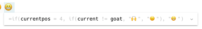

Bringing that together, I was able to execute the last, gamechanging row:
This formula basically checks, if the currentpos of the ball is 4 (so, 4 seconds after the click and directly at the realistcly drawn goal). If yes, it checks if the goat (our random number) will be at this row and show it. If not, it checks if this is our current column (the ball).
BONUS Make the audience go crazy
By checking, if the current column is the same as the goat colum, I made this “win” or “loose” indicator.
