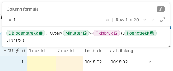

    In the Time table I have cutoff times that correspond to points in increments of 0.5, like 00:18:01 = 0.5 points, 00:19:01 = 1 point, etc. So, the idea is for the Main table to show 0.5 points between 00:18:01 and 00:19:00 and then shift to 1 point from 00:19:01,
    (And if there is a way to omit the unnecessary hours, I highly appreciate any suggestion)
The formula I thought worked for the Main table is
DB Poengtrekk: cut-off times and points database
Minutter: Time/minutes column in the points database
Tidsbruk: Time spent, from the Main table
Poengtrekk: Points column in the points database
The idea is that the time table is filtered based on the time and returns the corresponding point. The problem is that instead of changing to 1 point from 00:19:01, it changes already from 00:18:02.
Is there a way to solve this in a fairly easy way?
I apologize for not being able to share the database, it is a bit large and already contains PII.
hi @Kjell_Pettersen ,
Can you try this?
[DB poengtrekk].Filter(
Minutter.ToTime() >=
Tidsbruk.ToTime()
).Poengtrekk.First()

Thank you, @Christiaan_Huizer. Unfortunately, that formula does the exact same thing.
I played around a bit with using two time columns, From Time and To Time, to see if that would work better but I am not able to find a formula that can verify if a given time is found between the two, and then provide a corresponding number from the third column.

I forgot to be explicit about the thisRow which is crucial.
thisRow.Tidsbruk.ToTime()
and please take 5 minutes to share a demo doc, cheers, christiaan
