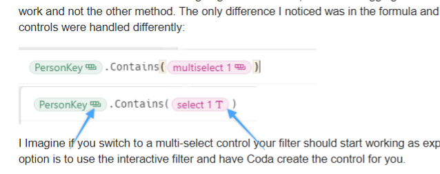

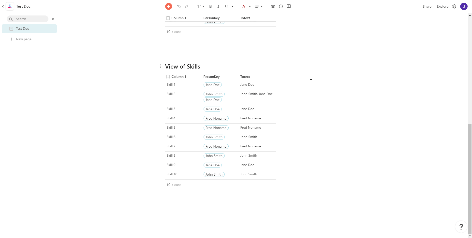

I actually set up a test doc to replicate what you are doing and ran into the same issue - I was using image instead of image . After some frustration I tried an Interactive Filter:
Which worked and was what I was going to recommend, but it was bugging me as to why that would work and not the other method. The only difference I noticed was in the formula and how the select controls were handled differently:
I Imagine if you switch to a multi-select control your filter should start working as expected. The other option is to use the interactive filter and have Coda create the control for you.
