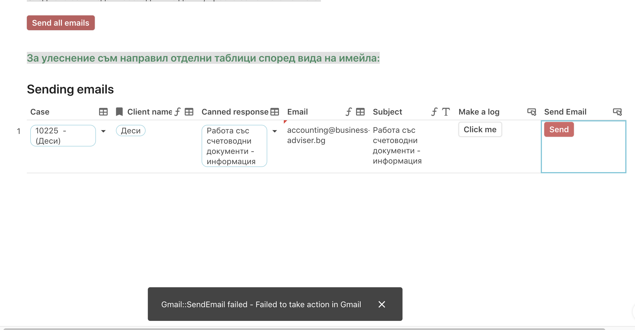

I have similar problem. I have made a button, which pushes all individual gmail buttons. The individual buttons work without any issues, but the other button gives an error: Gmail::SendEmail failed - Failed to take action in Gmail

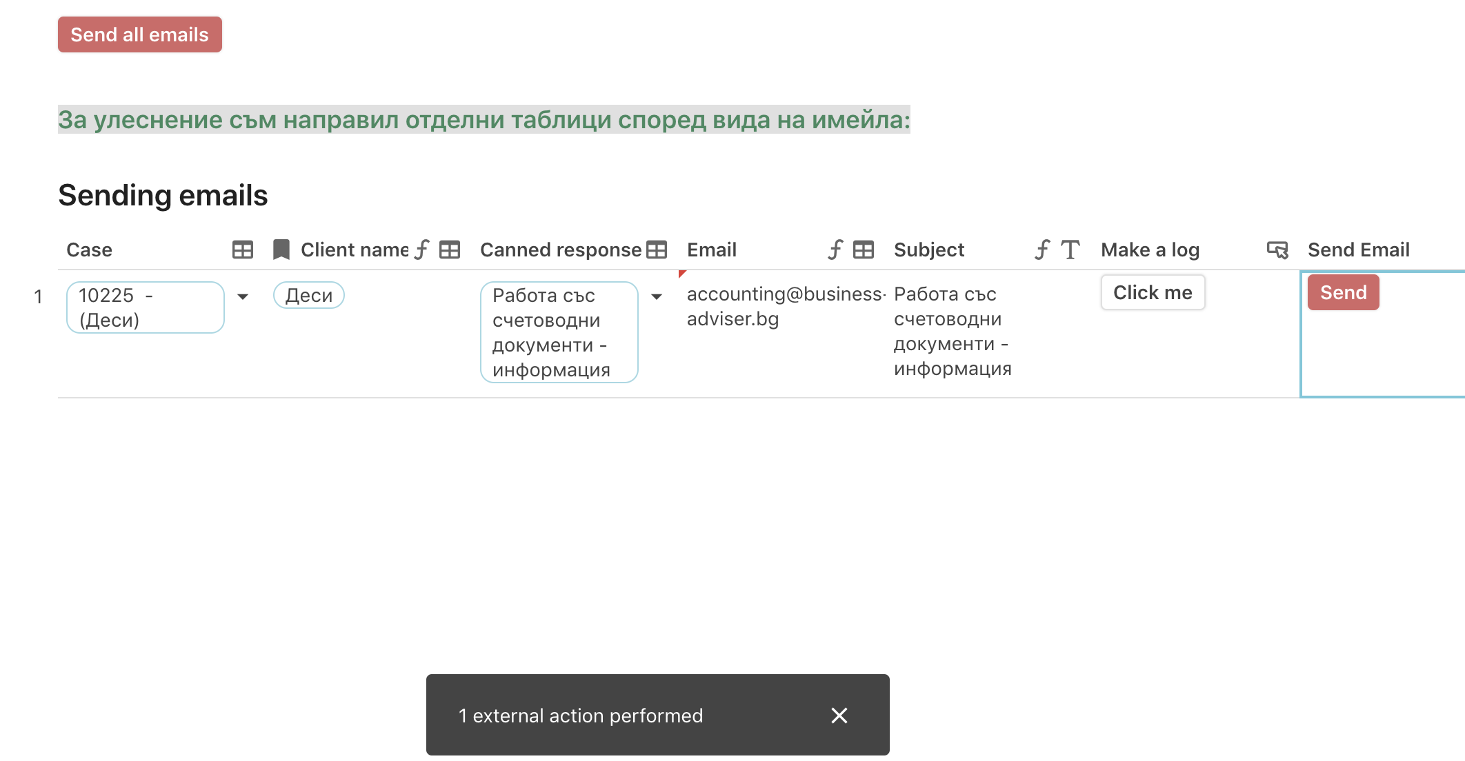

I have reconnected the pack, but unfortunately it still doesn’t work. The individual button works just fine, but the other button for some reason cannot push it. I attach screenshot of the setup, maybe I am doing something wrong.

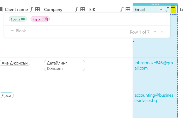

In the section “sending emails”, each column is a lookup, including the email that gives an error.
The marked with yellow is an error message
When you change the column property to “text” you will get the below output (hyperlink email)
Maybe you can give it another try, as the buttons seem to be okay.
