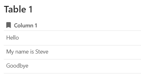

I’ve got a table, where each row is a new line of text. I want to output a block of text below the table that puts each row of that table on a new line.
So the following table:
Annotation%202019-08-23%20155701
Has a block of text below that automatically generates and looks like:
Hello
My name is Steve
Goodbye
I can’t get it to do this without inserting commas. I’ve been trying something along the lines of:
(=FormulaMap([Table1],concatenate(Column 1,character(10)))
