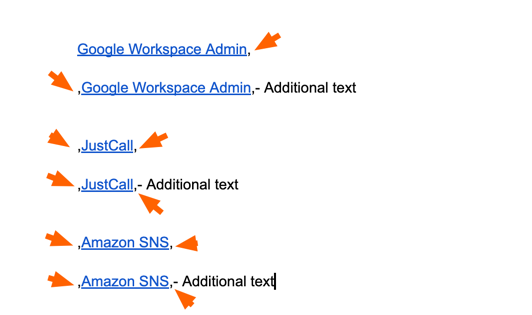

For the most part, this works well. The issue I’m running into is when I paste the content, it’s adding additional commas. For the life of me, I can’t figure out how to update the formula to not include those extra commas. If I replace all commas in the formula with +, then the hyperlinks don’t work. I’d appreciate any advice!

Screen Shot 2023-10-31 at 4.40.40 PM

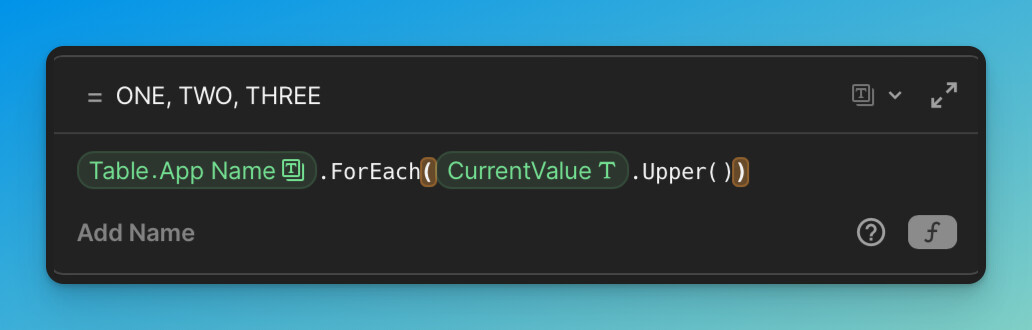

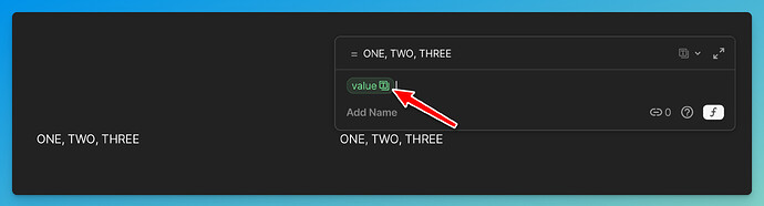

Notice here, I did a simple forEach() Loop on your table, and it returns the values in that table with a comma between each value because forEach() Loops ALWAYS return LISTS

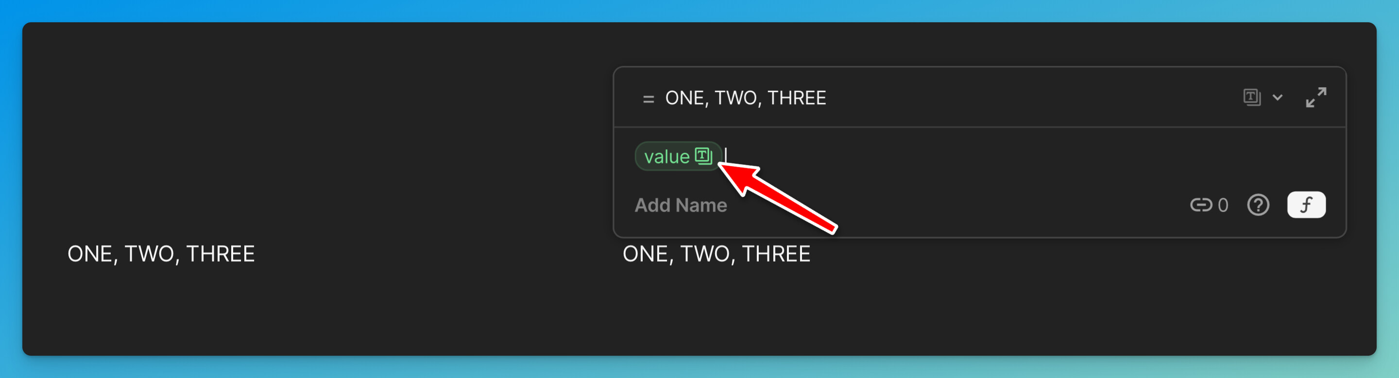

You can also confirm that the return type of a forEach() loop is a list here. The chip-icon on actual chip itself has a little shadow letting you know that the value is a list.
Here is full documentation on Coda formula chips and value types - I recommend giving it a look
So that is the source of your rouge commas - commas are an indication of a list. So how do we get rid of them?

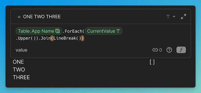

Well one really good way to turn lists into plain text value is to JOIN lists via a certain character. The Join() formula in Coda was made just for this!
Notice here with this simple forEach() list, I used Join(lineBreak()) which allowed me get ride of my commas, and return my values stacked!

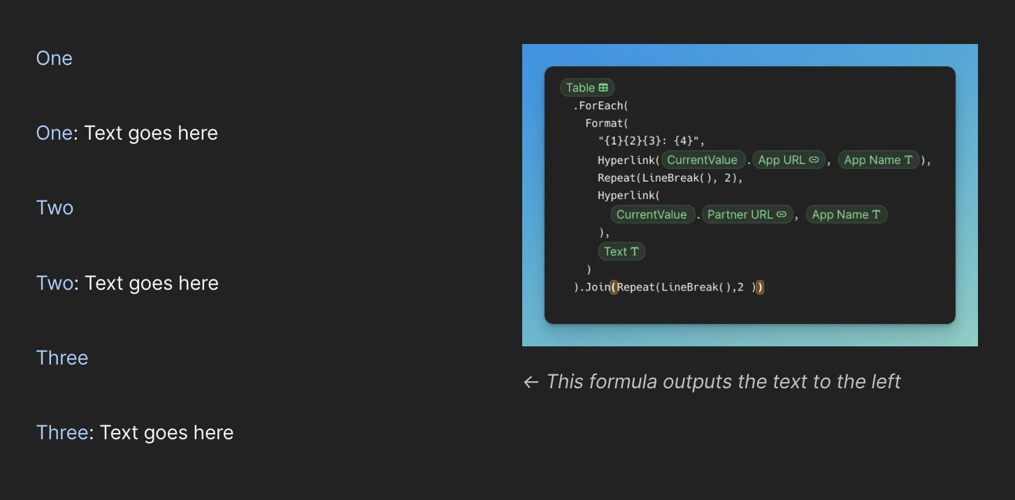

The solve to your specific problem
To be honest, Im not sure exactly what you’re looking for, but hopefully using the principles above you can get the formula you need!
Here is a small formula I wrote to mimic something similar to your output
