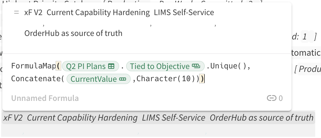

I’m trying to write out some lines in a table into text using FormulaMap()
Right now they all show up as a list, and I was trying to figure out a way to line break between the list. Any thoughts? Concatenate(Value, “\n”) etc aren’t seeming to work

Using Concatenate(CurrentValue, Character(10)) or CurrentValue + Character(10) in FormulaMap are both not working. The + is leading to crazy values (grid-843…), and the Concatenate is leading to commas on a second line vs actually moving the next item to the next line. Any thoughts?

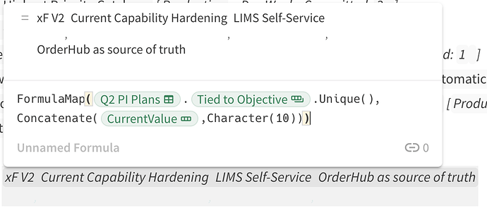

Hard to see the , that is there on the first one with the formula, attaching both
Second where you can see the comma

@mallika Here’s some quick testing:
BulletedList did fix it! But still seems quite buggy :slight_smile:
