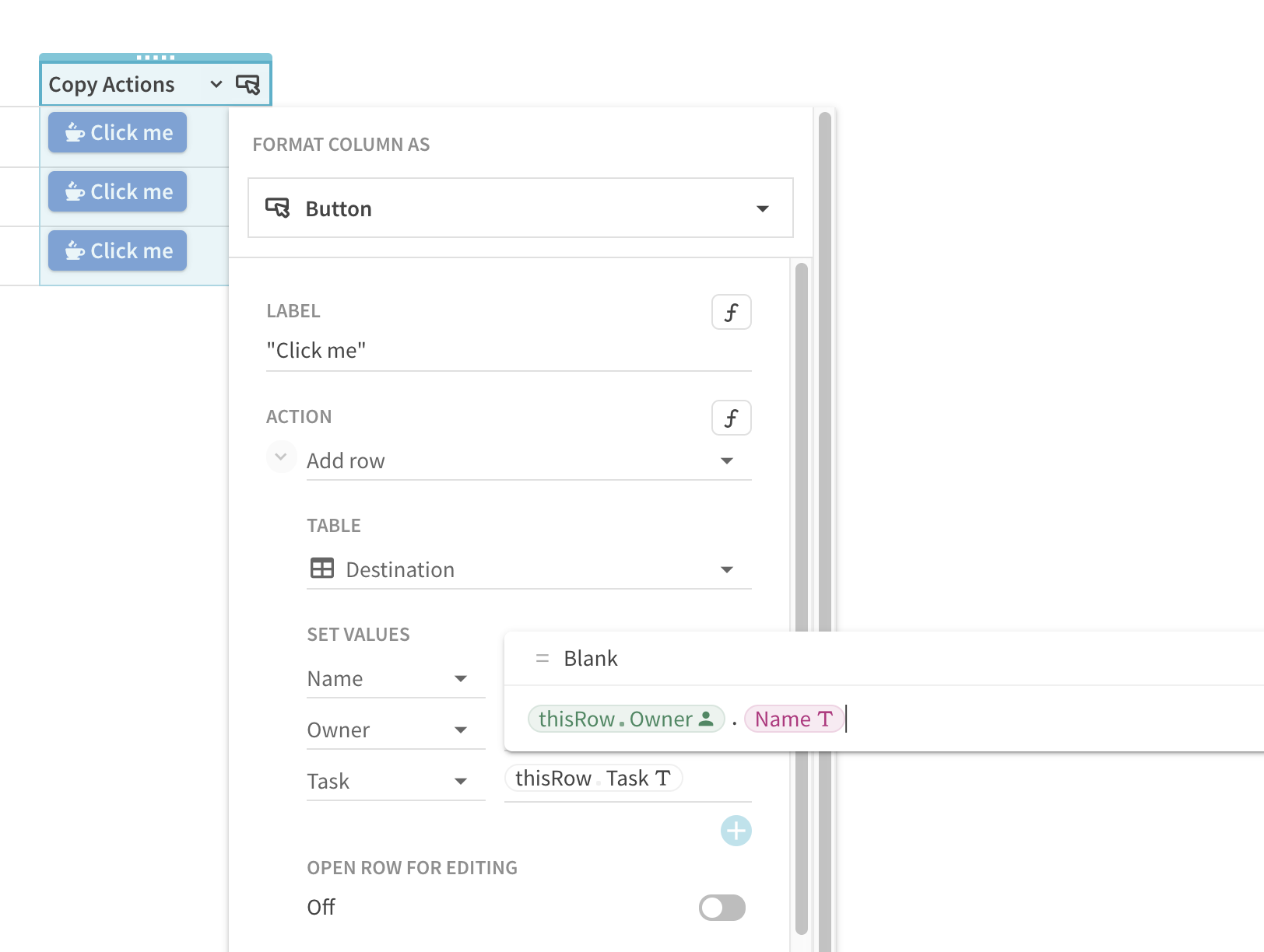

I am using Coda to generate task lists. Every time somebody joins a team, I want to be able to generate set of TODOs for various people.
Setting up buttons to copy a template row to another table works beautifully except that I am not able to copy “People” columns. The name makes it over, but coda doesn’t recognize it as a contact. I tried to look through coda functions to no avail.
My addrow column definition is attached as an image here.

Ah, using the value thisRow.Owner.Name rather than thisRow.Owner fixes the copy problem…That is, if you want to programmatically copy a “People” field over, use the expression peopleColumnName.Name for the copy to work right.
(Thanks for the reply, JP. I was just copying my name over from one table to another…)
For future readers, this post shows the pattern how you can initialize a new record using a template . How to create a set of records every time a new record is created in table
BTW, the definitive recommendation from the Coda team was to use the List function like so:
List(thisRow.Owner)
I needed to do this because the destination field was a People column that allowed for multiple selections. Thanks to Preeyanka for tracking this down.
