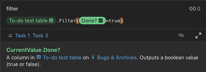

Now, from that list, all we want are the tasks where the checkboxes in the columns [Done?] are checked. In the sample below, those tasks are Task 1 and Task 3
Adding the filter, the formula will now look like this :
As you can see, the filter check the CurrentValue.Done? to return the appropriate list of rows from the table [To-do test table].
In other words, it takes the whole list of rows in that table and for each specific row, it goes and see what’s the current state of the checkbox in the column [Done?], what is the CurrentValue of the checkbox [Done?] for each row in that list…
And what the filter returns here is a “new” list of rows where the checkboxes are checked on which FormulaMap() will later act
Note that because you used checkboxes and checkboxes are booleans (meaning they can only have 2 values : True or False ) you actually don’t need to precise the true part… It’s implied

Your filter on the other hand, doesn’t check the CurrentValue.Done?.
It checks if in all the values in the columns [To-do test table].[Done?] there’s at least a true value. In other words, if at least one checkbox is checked. As in my sample I have 2, it returns all the rows in that table regardless of state of the checkboxes
. (More info about Contains()).
For the Filter() you could have written it like this too though :
or even using Contains() … as long as the filter checks the CurrentValue.Done?

The corrected filter return a list of tasks (a list of rows) where each specific checkbox in the column [Done?] is checked.
For each one of these rows we need to “move”, we need to add the very specific Task for that row stored/represented by CurrentValue.Task (in this case)
To be complete (At least trying to
The filter now returns the entire list of rows from the table [To-do test table] where [Done?] is checked. On top of that, by using FormulaMap() we ask that :
For each specific task (row) in that list, retrieve each specific value from the column Task in the table [To-do test table] and add it as the value in the column Task in the Archive table for this very specific task in the list.
