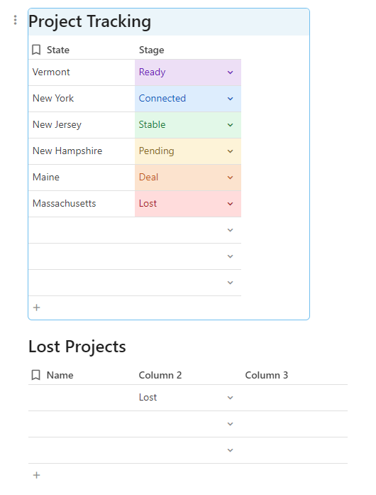

Hi Everyone,
As you can see, I have two tables. I am trying to make a button that moves certain rows from Project Tracking to Lost Projects. As the name implies, I want to move the rows in the “Lost” stage under Project Tracking. So far I have been having trouble copying the exact rows from table to table, instead I keep getting rows that say “false”. My end goal is to then automate the button to be pressed weekly or so. Any help would be greatly appreciated, thanks!

Thanks for the reply! I like your idea with the three buttons, but I am having trouble with the arguments. I need to target specific rows in the Project Tracking table under the “Lost” stage, and then move that exact row into the Lost Projects table. I’m not quite sure what the formula should look like yet. The reason I don’t want to use filters is because I am hoping to create a button that moves these rows weekly.
So far I have something like:
RunActions(addrow([Lost Projects],[Lost Projects].Stage,[Project Tracking].Stage=“Lost”,[Lost Projects].State,[Project Tracking].Contains(“Lost”)))
However this just adds a row that says “false” under each column.
