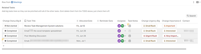

I have a ‘Tasks’ database that can be assigned to a ‘Client’
I have a ‘Meetings’ database with the following notable columns
  1. ‘Client’ single select drop down
  2. ‘Tasks’ relation shown as a table
    (See photo below)

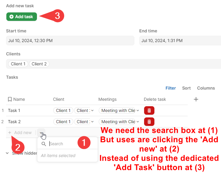

Hi @anon1959570 , Thanks for the quick reply.
Yes a button does work. It has the following limitations which I am hoping to avoid
  1. On the ‘Meeting’ record, ‘Tasks’ table we need the ‘New row button below table’ as it allows us to search for existing tasks and link them. However, this creates a scenario where uses may click the ‘Add Row’ button instead of the ‘Add Task’ button.
    In this scenario, the system does not auto fill [Client] on the ‘Task’ record when the ‘New Row’ button is clicked or a new task is linked.
  2. Its not such an issue in this example but extra controls clog up interfaces and I try to avoid them were possible.

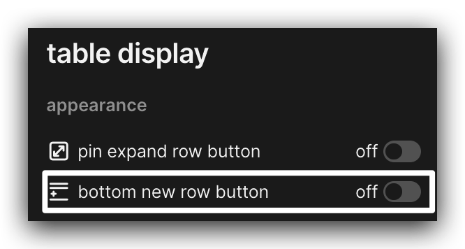

on #2, why not hide the “bottom new row button” ?
so that you then at least “force” the user to use the add new task button.
additionally, why not move the “add new task” button closer to the table so it feels more natural?

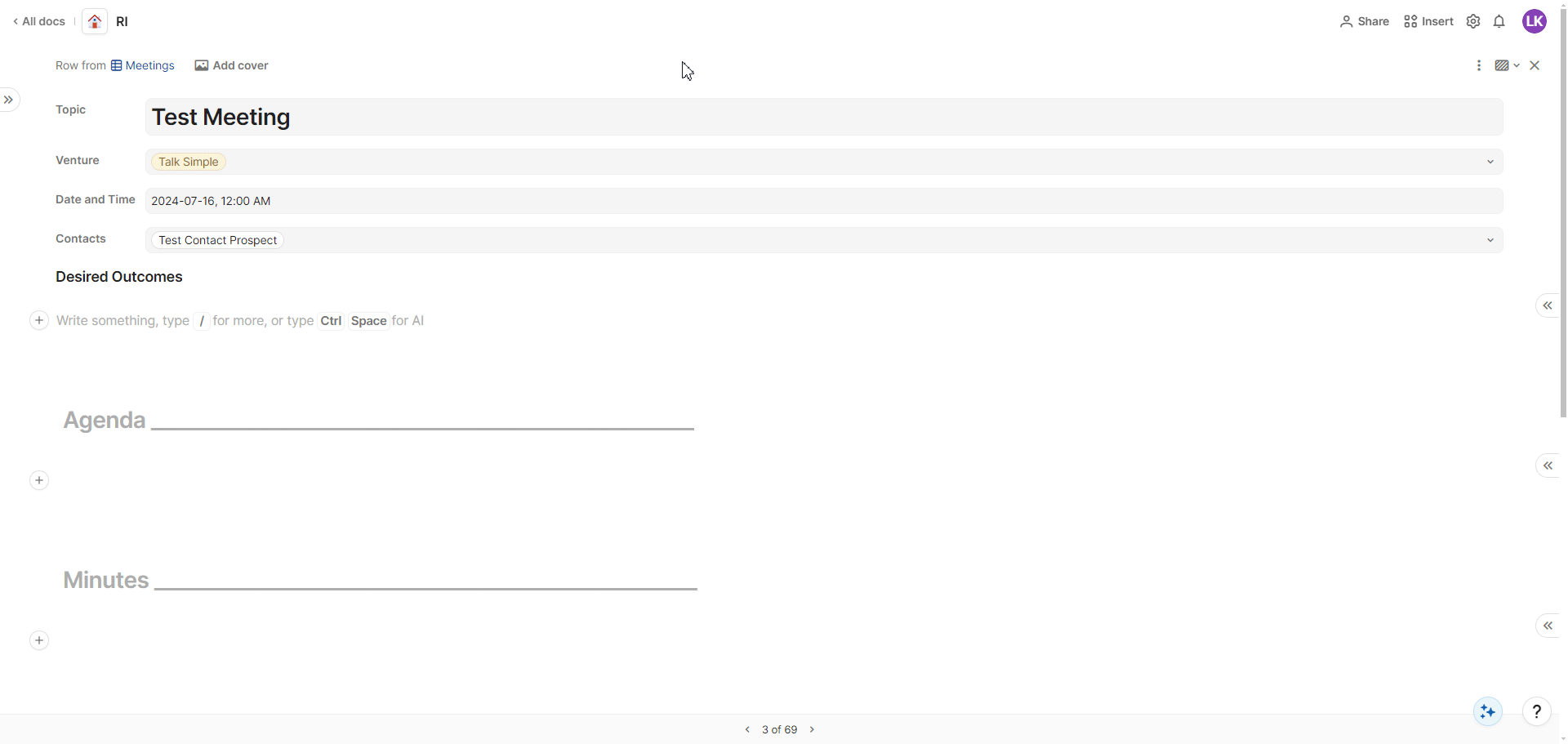

What’s more, I have it working without buttons. But only in one place and cant replicate it. Take a look.
[Venture] autofill’s correctly on the ‘Task’ when created from ‘Contact’ → Working!
Note: ‘Client’ was renamed to ‘Contact’.
chrome 2024-07-16 T21.36.38.728
(GIF 1)
[Venture] IS EMPTY on the ‘Task’ created from ‘Meeting’ → Not working.
chrome 2024-07-16 T21.39.23.553
(GIF 2)

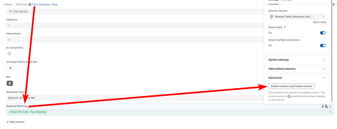

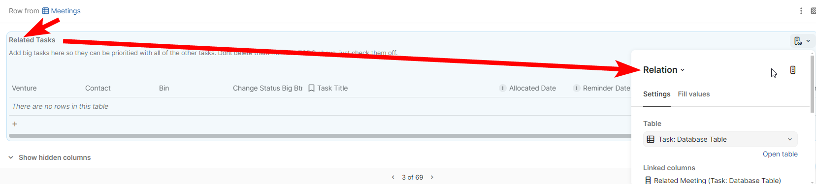

Wow! I just figured it out!
It has to do with the difference between
  • Relation
  • Linked Relation
And it turns out the order matters!

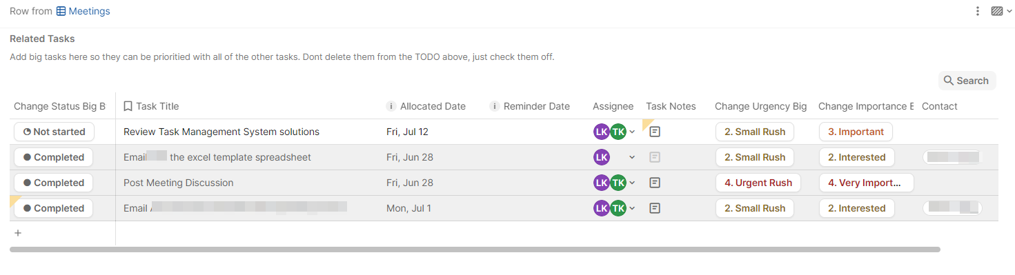

In the above post the ‘Meetings’ record [Related Task] column was a ‘Relation’ column.
This was GIF 2 and it did not work.
(Image 1)

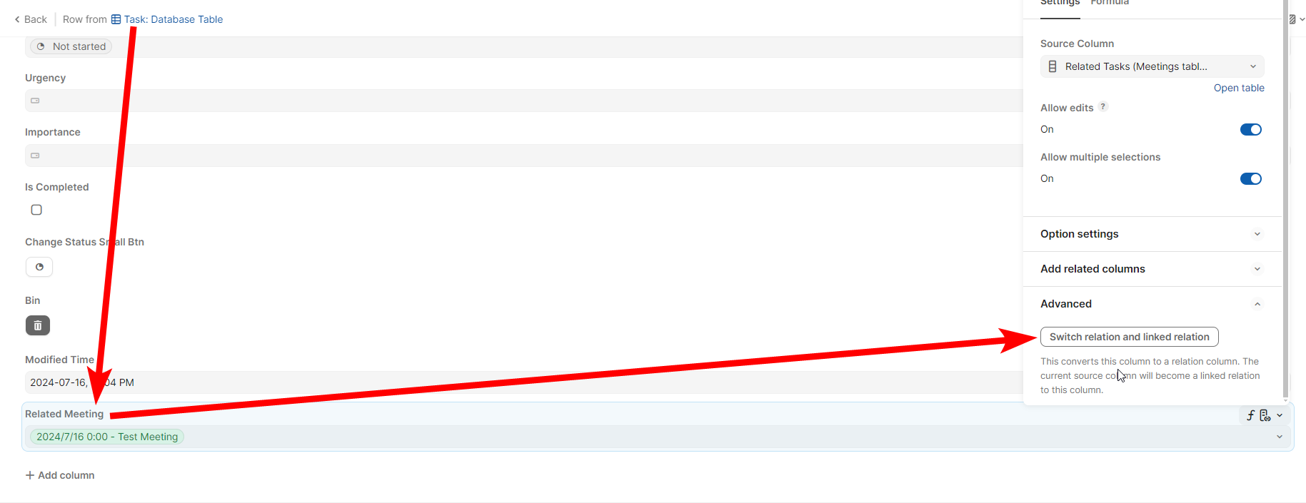

However, if you go to the ‘Task’ table and on the [Related Meeting] column click the option “Switch relation and linked relation” it seems to make it work!
(Image 2)

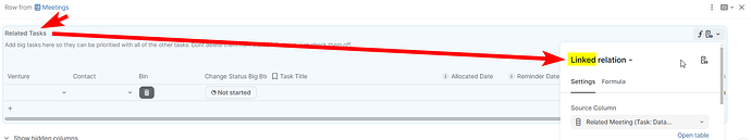

This changes what we see in Image 1 to say ‘Linked Relation’ instead of ‘Relation’.
(Image 3)
Now see the same test used in GIF 2 now has a different result. It successfully auto fills the [Venture] field.
