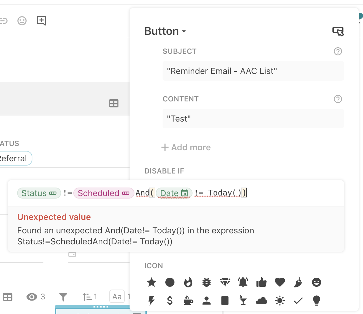

I’m trying to figure out how to create automatic reminder emails based on 2 concurrent factors: a dropdown list and a date.
I don’t know how to insert a code, but I can put in a screenshot (below). Essentially, I have a list of todos, and some of them are follow ups. I have so many that I need them emailed to me as a sort of (mental) filter. I want the item emailed to me if the row meets 2 criteria: status=scheduled and date=today. How do I do that? Seems like it’d be simple but I just can’t get it to work. Below is the formula I’m using . . .
Hi Ben, the correct syntax there is And(test1, test2), or alternatively test1 and test2 (without parentheses). So in your case just remove the parentheses and it works.
Having said that, given your use case you actually need to use OR instead of AND.

@BenLee It’s in the “disable if” - you want it to be disabled if the criteria is not met so the ‘not equals’ is correct.
And it should be OR - you want it to be disabled if either of the criteria is not met, or in other words - you want to enable it only if both criteria are met

@Asaf_Dafna, you’re totally right. I missed that this was in the Disable part of the button. Using OR is the way to go as well as !=.

It looks to be working properly if I use this for the formula…
thisRow.[Task Status] != "Scheduled" OR thisRow.[Due/Done Date]!= Today()
