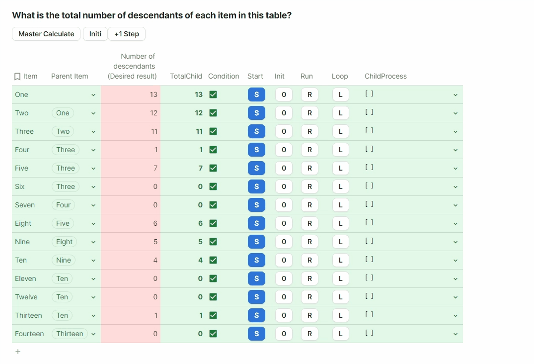

If one row has a child and that child has a child and so on…
How many descendants does the original item have in total?
Here is a doc with desired results and a visual that explains what I’d like to achive:

We will use a while loop, each step will iteratively calculate the child(s) of items, as long as there is at least one child. We will calculate the sum of the child and increase the total number each time. Once the child column is blank, the while loop will stop.
Here is what it looks like
I need :
To process that :
Start by setting an initalization column. This will find, for each row, what is the first level of child. We need that before we start our loop, and we store thoses values inside ChildProcess column. But as we want to initialize only once, we need to put it outside of the loop. You can see that we initialize also the number of child.
If I show you this step only, this is the result i got with only “initialization” process.
OK, then the core of the process is in the Run button, the code is here but please check it directly in embed doc for better view

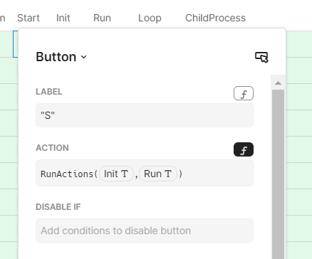

Define a Start Button, that will initialize and start the first run
Finally Add a master button that will activate each start button !

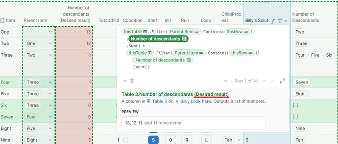

I think there may be a simpler way here.
If you create a column called “# of Descendants”, set it to select rows with Parent.contains(thisRow) and then sum their # of descendants +1 each, you’ll get an automatic recursion down to the bottom.
Num Of Descendants Column Formula:
ThisTable.Filter([Parent Item].Contains(thisRow)).[Num of Descendants].Sum() + ThisTable.Filter([Parent Item].Contains(thisRow)).[Num of Descendants].Count()

I already tried something like this, had the same idea but it only went 2 levels deep and now I got the same result, but I might have done something wrong.
Give me a minute, I will try again.
Oh, ok I see now, thanks so much @Billy_Jackson !!! That’s perfect!

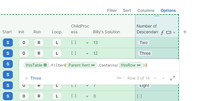

I don’t think the formula works, I believe you accidentally referenced to a wrong column.
Because if I delete the Number of Descendants (Desired Result) column, Billy’s Solution is an error.
And if I reference it to the right Number of Descendants column, it gives an error as well. Sum() function needs to be a number or something.
Or am I missing something?
I think there is an extra column at play here. The key to this working is that the formula is summing ITS OWN COLUMN. So in this case, it should be summing “Billy’s Solution” rather than a separate filtered column
