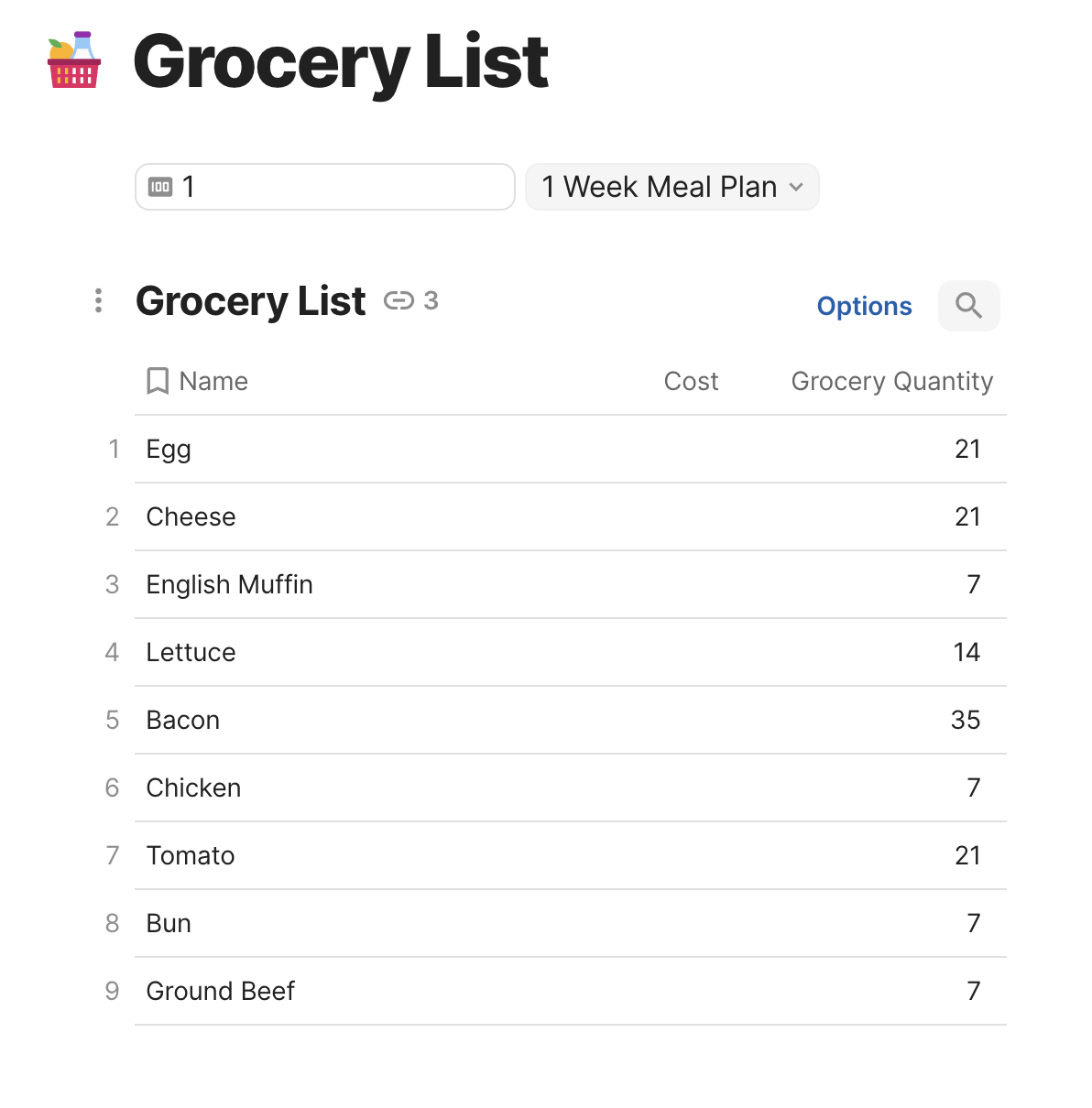

Below is an edited version of your doc with some changes to the items and bundles. The number one issue I am trying to resolve is how to generate a list of all sub-items (and sub-sub-items, and sub-sub-sub-items, and…you get the idea) to an item, with the corresponding quantities.
In the version below, I have a meal plan for 1 week with 3 really basic meals for each day (very boring and not super healthy meal plan).
If I was shopping for this meal plan for the entire week, I would want to know how much of each ingredient to buy.
For instance, I would need a total of 21 eggs (2 per Cobb salad, 7 times a week + 1 per breakfast sandwich, 7 times a week) and 35 pieces of bacon (2 per Cobb salad, 7 times a week + 1 per breakfast sandwich, 7 times a week + 2 per hamburger, 7 times a week).

Hey Chris,
Here’s an updated doc with a grocery list

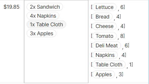

That is a really cool setup! It looks like there might be a small issue with how the quantities/totals are being calculated:
In this screenshot, I have 1 basket selected. You can see that the purchase cost total is $14.65, while the total cost is $19.85 (a difference of $5.00 for the basket and $0.20 X 2 for the sandwiches). My first thought was that the $0.10 and $5.00 were assembly costs and maybe you didn’t want to include those in the pricing, but the basket would still need to be purchased.
For some reason, the List(Item, Quantity) is not showing the sandwiches, despite having them listed in the Items column:
Ah, yeah I added Purchase Cost on a whim. Changing Total Cost to be named Total Unit Cost, good catch.
Yeah, List(Item, Quantity) only shows the base items you need to purchase, not the intermediate assemblies.
