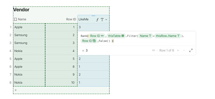

I set something like this once, but i’m sure there is some more elegant way to proceed.
In the table you want to refer with lookup, I created a “LikeMe” check with Rank. You will get different value, what’s interesting is that each brand get a unique “1” once
Then use custom filter in lookup option in your main table, and filter by LikeMe=1
And then it does the job… but interested for better answer !

I assume Unique() is not a way to use in custom filter for lookups, but maybe I’m wrong. I did not figure out how to syntax it directly. Maybe more experienced coda expert than me would enlight this ![]()
Anyway, I think this solution is not that complicated and works quite great !
