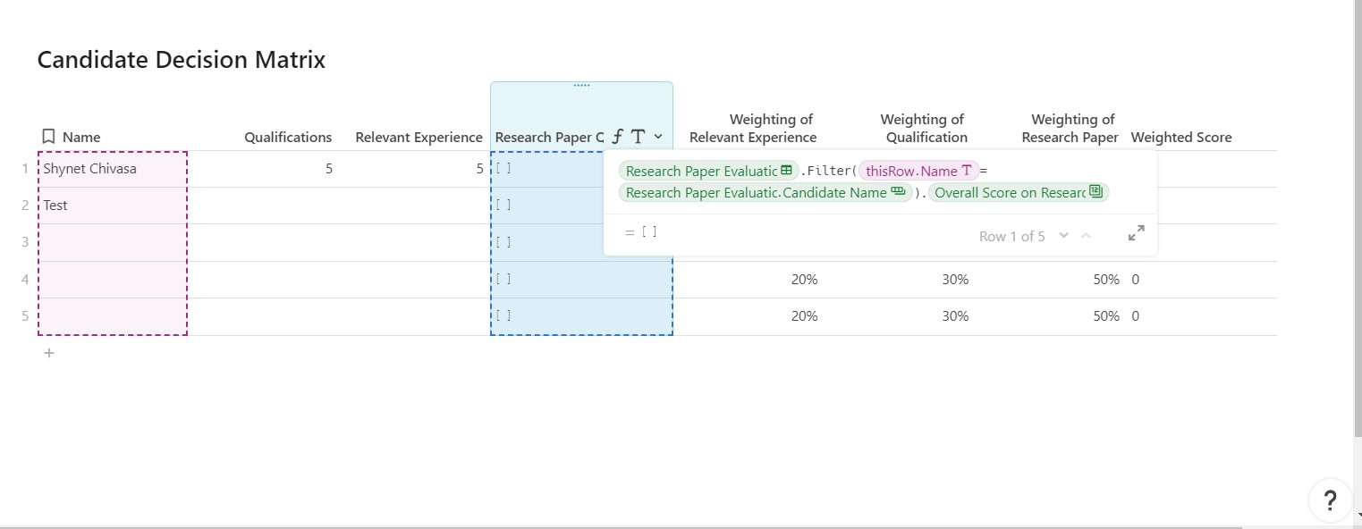

I have a table called Candidate Decision Matrix and another table called Research Paper Evaluation matrix (images of sub tables attached) . The tables are linked by the name of the candidate. I want to bring the Overall Score on Research Ability for each candidate from the table Research Paper Evaluation Matrix to the Candidat
e Decision Matrix table. I have tried the formula ResearchPaperEvaluationMatrix.Filter.IThisRow.Name= ResearchPaperEvaluationMatrix.CandidateName).Overall Score on Research Ability but this yields not result, how can I fix this

Your filter formula is attempting to compare via = a text value and a list of rows. For that filter formula to work you will need to compare like values (text to text or Row row to row)

The problem here, as said by @Scott_Collier-Weir , is that you’re trying to compare in your filter 2 different things : a row (which seems to be a reference coming from somewhere else) and a Text value, which will never work (but without having a sample doc to look at, it’s hard to give you a precise answer)
Could you try something like :
ResearchPaperEvaluationMatrix.Filter.(CandidateName.[ColumnContainingThe Name] = thisRow.Name).[Overall Score on Research Ability]
Note that this might not work as it depends on your actual setup

How you could do this is on your Research Paper table create a column with the formula [candidate Name].Name, call it “Name” and then reference that column inside your filter formula like this:
* [Research Paper Evaluation Matrix].Filter(thisRow.Name = Name).[Overall Score on Research Ability]
That will prevent your filter formula from un-necessarily calculating values and keep it fast in the long run!
I added another column next to PCH’s with that formula on it as an example on your original doc! Hopefully that helps. Also, see this article about optimizing formulas, its super helpful! → Optimizing Formulas
