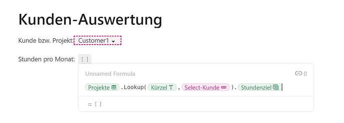

Ok, next step:
Now I want to pull the number of hours for the selected customer from table “Projekte” and show it here.
My approach doesn’t work, might again be a problem with the variable type:
I’ve read the doc that you’ve linked but I couldn’t apply it. :frowning:
It can be tricky to use formula on the canva but here I’ve got 2 apparently working formulas :wink: :
Here, it’s not really a problem of different variables (well there is one in your lookup()), but a missing part and that’s why both formulas use .Value to indicate to the formula that you’re looking for a precise data for the actual value selected in your select list :wink: (otherwise, the data you’re looking for could be the data of any selectable options referenced by your select list). So you weren’t that far with your Lookup() :wink:
Because your select list is already a reference, you can just use this first formula that sort of say that for the .Value selected in the select list, get the Stundenziel :wink:
  • [Select-Kunde].Value.Stundenziel
The second formula is a Lookup() that compares the Text field [Kürzel] in your table Projekte to the actual Value of your select list, which is a reference at this point. So to pull out the Text field and make the comparison doable, you need to indicate where to get the Text : in this case, it’s the field [Kürzel] too : which gives you this part of the formula : [Select-Kunde].Value.[Kürzel] :slight_smile: .
  • Lookup(Projekte,[Kürzel],[Select-Kunde].Value.[Kürzel]).Stundenziel
I’m not sure it’s very clear, but it’s really hard to explain those kind of subtleties :sweat_smile:
