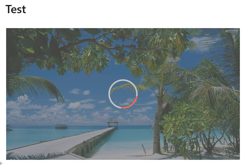

I have uploaded images less than 1MB, but the upload is never completed.
Loading icons don’t disappear. (I waited for at least 5 mins.)

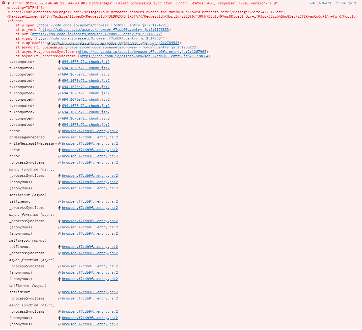

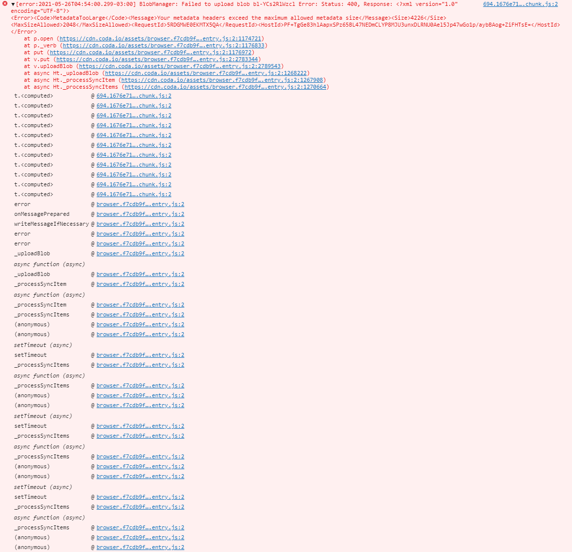

Not sure if I can share the entire doc due to NDA I have with the project/company. However, I can confirm it is doc specific. The doc has a lot of content so perhaps it is related to that.

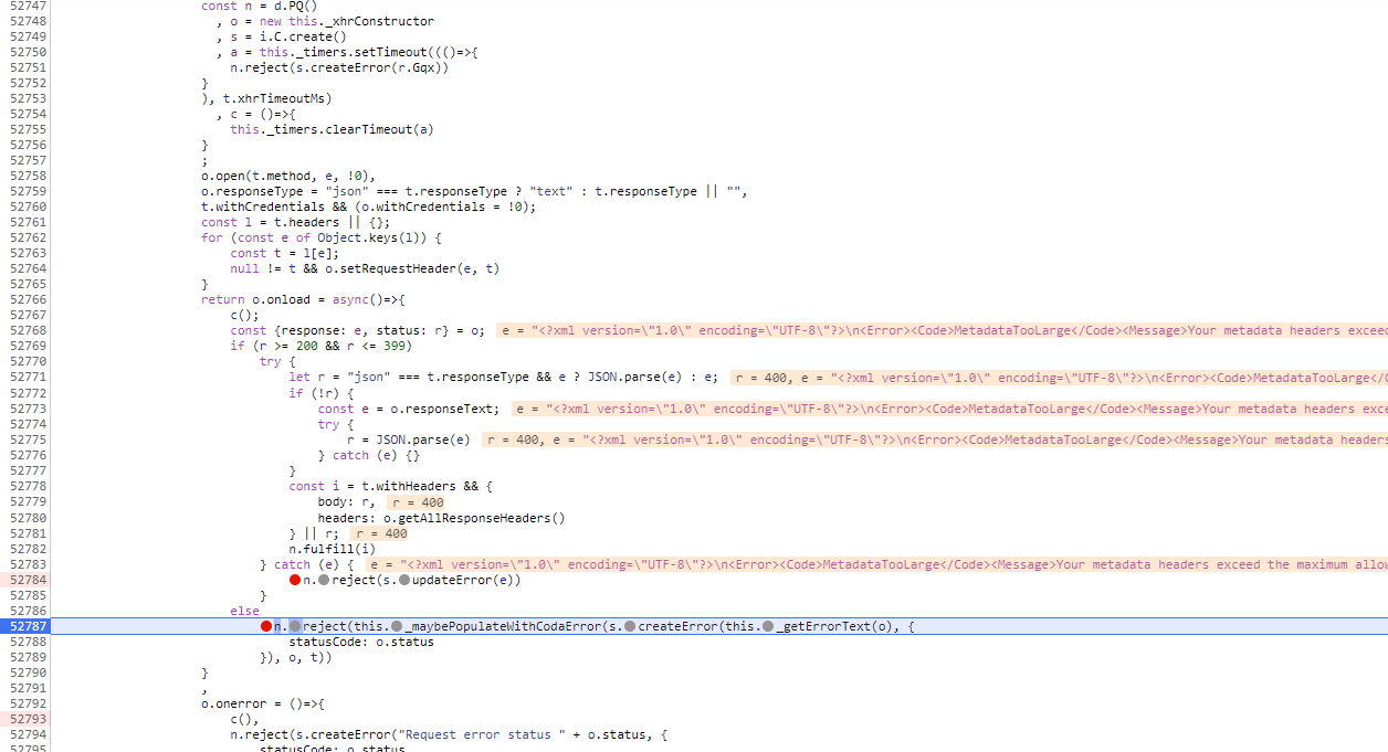

In edge, I see the following error. Note that I do not get it in Chrome with the same doc. I also do not get it in Edge with a fresh doc
Unfortunately the code is obfuscated but here is the value of t.headers
“Accept”: “text/plain”,
“X-Csrf-Token”: “ZFFLWO13anJmThG7”,
“content-disposition”: “attachment; filename=Ink%20Drawings%0D%0AInk%20Drawings%0D%0AInk%20Drawings%0D%0AInk%20Drawings%0D%0AInk%20Drawings%0D%0AInk%20Drawings%0D%0AInk%20Drawings%0D%0AInk%20Drawings%0D%0AInk%20Drawings.png”,
“x-amz-content-sha256”: “645a89e61147f7cd53f058ab6d4a38a0bdca73a9a906d8a96c29c3287600a41f”,
“x-amz-meta-filename”: “Ink%20Drawings%0D%0AInk%20Drawings%0D%0AInk%20Drawings%0D%0AInk%20Drawings%0D%0AInk%20Drawings%0D%0AInk%20Drawings%0D%0AInk%20Drawings%0D%0AInk%20Drawings%0D%0AInk%20Drawings%0D%0AInk%20Drawings%0D%0AInk%20Drawings%0D%0AInk%20Drawings%0D%0AInk%20Drawings%0D%0AInk%20Drawings%0D%0AInk%20Drawings%0D%0AInk%20Drawings%0D%0AInk%20Drawings%0D%0AInk%20Drawings%0D%0AInk%20Drawings%0D%0AInk%20Drawings%0D%0AInk%20Drawings%0D%0AInk%20Drawings%0D%0AInk%20Drawings%0D%0AInk%20Drawings%0D%0AInk%20Drawings%0D%0AInk%20Drawings%0D%0AInk%20Drawings%0D%0AInk%20Drawings%0D%0AInk%20Drawings%0D%0AInk%20Drawings%0D%0AInk%20Drawings%0D%0AInk%20Drawings%0D%0AInk%20Drawings%0D%0AInk%20Drawings%0D%0AInk%20Drawings%0D%0AInk%20Drawings%0D%0AInk%20Drawings%0D%0AInk%20Drawings%0D%0AInk%20Drawings%0D%0AInk%20Drawings%0D%0AInk%20Drawings%0D%0AInk%20Drawings%0D%0AInk%20Drawings%0D%0AInk%20Drawings%0D%0AInk%20Drawings%0D%0AInk%20Drawings%0D%0AInk%20Drawings%0D%0AInk%20Drawings%0D%0AInk%20Drawings%0D%0AInk%20Drawings%0D%0AInk%20Drawings%0D%0AInk%20Drawings%0D%0AInk%20Drawings%0D%0AInk%20Drawings%0D%0AInk%20Drawings%0D%0AInk%20Drawings%0D%0AInk%20Drawings%0D%0AInk%20Drawings%0D%0AInk%20Drawings%0D%0AInk%20Drawings%0D%0AInk%20Drawings%0D%0AInk%20Drawings%0D%0AInk%20Drawings%0D%0AInk%20Drawings%0D%0AInk%20Drawings%0D%0AInk%20Drawings%0D%0AInk%20Drawings%0D%0AInk%20Drawings%0D%0AInk%20Drawings%0D%0AInk%20Drawings%0D%0AInk%20Drawings%0D%0AInk%20Drawings%0D%0AInk%20Drawings%0D%0AInk%20Drawings%0D%0AInk%20Drawings%0D%0AInk%20Drawings%0D%0AInk%20Drawings%0D%0AInk%20Drawings%0D%0AInk%20Drawings%0D%0AInk%20Drawings%0D%0AInk%20Drawings%0D%0AInk%20Drawings%0D%0AInk%20Drawings%0D%0AInk%20Drawings%0D%0AInk%20Drawings%0D%0AInk%20Drawings%0D%0AInk%20Drawings%0D%0AInk%20Drawings%0D%0AInk%20Drawings%0D%0AInk%20Drawings%0D%0AInk%20Drawings%0D%0AInk%20Drawings%0D%0AInk%20Drawings%0D%0AInk%20Drawings%0D%0AInk%20Drawings%0D%0AInk%20Drawings%0D%0AInk%20Drawings%0D%0AInk%20Drawings%0D%0AInk%20Drawings%0D%0AInk%20Drawings%0D%0AInk%20Drawings%0D%0AInk%20Drawings%0D%0AInk%20Drawings%0D%0AInk%20Drawings%0D%0AInk%20Drawings%0D%0AInk%20Drawings%0D%0AInk%20Drawings%0D%0AInk%20Drawings%0D%0AInk%20Drawings%0D%0AInk%20Drawings%0D%0AInk%20Drawings%0D%0AInk%20Drawings%0D%0AInk%20Drawings%0D%0AInk%20Drawings%0D%0AInk%20Drawings%0D%0AInk%20Drawings%0D%0AInk%20Drawings%0D%0AInk%20Drawings%0D%0AInk%20Drawings%0D%0AInk%20Drawings%0D%0AInk%20Drawings%0D%0AInk%20Drawings%0D%0AInk%20Drawings%0D%0AInk%20Drawings%0D%0AInk%20Drawings%0D%0AInk%20Drawings%0D%0AInk%20Drawings%0D%0AInk%20Drawings%0D%0AInk%20Drawings%0D%0AInk%20Drawings%0D%0AInk%20Drawings%0D%0AInk%20Drawings%0D%0AInk%20Drawings%0D%0AInk%20Drawings%0D%0AInk%20Drawings%0D%0AInk%20Drawings%0D%0AInk%20Drawings%0D%0AInk%20Drawings%0D%0AInk%20Drawings%0D%0AInk%20Drawings%0D%0AInk%20Drawings%0D%0AInk%20Drawings%0D%0AInk%20Drawings%0D%0AInk%20Drawings%0D%0AInk%20Drawings%0D%0AInk%20Drawings%0D%0AInk%20Drawings%0D%0AInk%20Drawings%0D%0AInk%20Drawings%0D%0AInk%20Drawings%0D%0AInk%20Drawings%0D%0AInk%20Drawings%0D%0AInk%20Drawings%0D%0AInk%20Drawings%0D%0AInk%20Drawings%0D%0AInk%20Drawings%0D%0AInk%20Drawings%0D%0AInk%20Drawings%0D%0AInk%20Drawings%0D%0AInk%20Drawings%0D%0AInk%20Drawings%0D%0AInk%20Drawings%0D%0AInk%20Drawings%0D%0AInk%20Drawings%0D%0AInk%20Drawings%0D%0AInk%20Drawings%0D%0AInk%20Drawings%0D%0AInk%20Drawings%0D%0AInk%20Drawings%0D%0AInk%20Drawings%0D%0AInk%20Drawings%0D%0AInk%20Drawings%0D%0AInk%20Drawings%0D%0AInk%20Drawings%0D%0AInk%20Drawings%0D%0AInk%20Drawings%0D%0AInk%20Drawings%0D%0AInk%20Drawings%0D%0AInk%20Drawings%0D%0AInk%20Drawings%0D%0AInk%20Drawings%0D%0AInk%20Drawings%0D%0AInk%20Drawings%0D%0AInk%20Drawings%0D%0AInk%20Drawings%0D%0AInk%20Drawings%0D%0AInk%20Drawings%0D%0AInk%20Drawings%0D%0AInk%20Drawings%0D%0AInk%20Drawings%0D%0AInk%20Drawings%0D%0AInk%20Drawings%0D%0AInk%20Drawings%0D%0AInk%20Drawings%0D%0AInk%20Drawings%0D%0AInk%20Drawings%0D%0AInk%20Drawings%0D%0AInk%20Drawings%0D%0AInk%20Drawings%0D%0AInk%20Drawings%0D%0AInk%20Drawings%0D%0AInk%20Drawings%0D%0AInk%20Drawings%0D%0AInk%20Drawings%0D%0AInk%20Drawings%0D%0AInk%20Drawings%0D%0AInk%20Drawings%0D%0AInk%20Drawings%0D%0AInk%20Drawings%0D%0AInk%20Drawings%0D%0A”,
“policy”: “eyJleHBpcmF0aW9uIjoiMjAyMS0wNS0yNlQwODo1OToxOC4yNDhaIiwiY29uZGl0aW9ucyI6W1siY29udGVudC1sZW5ndGgtcmFuZ2UiLDAsMjA5NzE1MjBdLFsic3RhcnRzLXdpdGgiLCIkQ29udGVudC1UeXBlIiwiaW1hZ2UvIl1dfQ==”,
“content-type”: “image/png”,
“x-amz-meta-mime-type”: “image/png”,
“x-amz-security-token”: “FwoGZXIvYXdzEJH//////////wEaDHOsYKBzvH4aC+KfpCKVBGIsP43N6h6MBqRJMI7NFr2iSiSQWhrKykW3LDTEtCucLq7FEaNxVUHDqyDlEb2OElCohRNOgxONmZXl3Akxt0CZBor/3DjyXLsslpcgjiARS9ixC4e/TT6ipklc+7fQKykkXOLUOhLbIgosr4ods5l4UTHxjDkpCDzWD6+jgNFsIgzH+lD2uGrF6sVutxChyPPAEEy0mEiPQH4G6QPuQVwg1m/CONE7qAcRdBmZH5H9kyEPB4GYFaC4CWMvGVKTGUZyI5IqLPBJ0Q70oNeTsFGpYQN3aw+M/pNmOZREBaCsHvg3Y34FNOSWOZ3YS9oJNqyhYkOa2UMvB+x68zk34rlJqzK4pjdOiwVyI0lmzXSaxMiTrA+IlQSl23ubFIf4NGX+XDoTAFHqkIVbJtCjP770c3XSB3op7BC7t5EPVviMc/SLestYsv1Eewv2ajXlsyHXNNJngtaPLCrAaNC7fKxkzXMZxyKVDtBOO+uuahhmn6p2CS17bIz0h9ABkV8WpzD/UsS3bxtU3kPpnr8nhiqRUJNm872FZXp4f6G1RvO69pN+ixVKMng0mGVNDgd8XnypGD9QELGVPMGFCQ+9ZNRfG1gXLpBCV8/RYsMG6U+FKLFY4YO9nlR6a34lCzjy5qzzZr8Btvenoenwd+DpNhB5aEYL0c59qmV+vFNSqTWFXU0pSMWAH+mKUrizcnoeT/fye+9HKNb/t4UGMiqHGkG24wy0T+sjHw/0y6400Ec8urvSkyGfjkgbqJFbEX31OJ5HKXZ6d+M=”,
“x-amz-date”: “20210526T075918Z”,
“Authorization”: “AWS4-HMAC-SHA256 Credential=ASIAQNTH22RI3VHJSPXC/20210526/us-west-2/s3/aws4_request,SignedHeaders=content-disposition;content-type;host;x-amz-content-sha256;x-amz-date;x-amz-meta-filename;x-amz-meta-mime-type;x-amz-security-token,Signature=3cfa5f6fc37f2722e4ef5df8cddce36de1770f9a2023abbe7521bd13314286bc”
Sorry for the delayed response! I was out last week
It looks like you hit a bug with how we’re encoding filenames. The fix should be deployed tomorrow. I’ll check back in with you when it is to make sure it’s resolved
