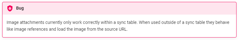

So ImageAttachment is what you want, but there’s a limitation:
Where are your source images coming from? Would it make sense to load them in via a sync table?
I’ve not seen the specific behavior you are talking about, with images not loading correctly, but happy to take a look at your code and doc to troubleshoot.
