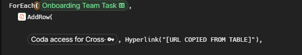

I am trying to add rows to a table using the Cross Doc AddRow. No matter how I try to input the table url, I keep getting the same error: “Input does not look like a table or view URL.”
I get the link from the table I want to add rows to.
In a separate table I have a button formula column, and I’ve tried to enter the URL several different ways:
I’ve tried to enter it as a regular string without the Hyperlink(), I’ve tried to enter it without quotation marks. Not sure what I’m doing wrong.
Onboarding Team Task is the table I have the rows that I want to add to Onboarding Task List - Cross Doc.

Hey Samuel, sorry for the confusion here. The link you’re grabbing is actually for the line that the table is sitting on vs the table itself. More on this here: Coda URLs Explained.
To grab the table link, click the table title/header and grab the link from the address bar. Another way is to find your Cross-doc sync table and right-click the link to your source table, which can be found under the table header titled here.
