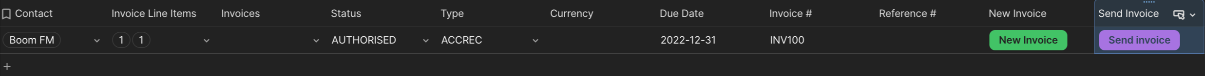

Hi folks,
Context:
In the screen shot below, I have an invoice generator which pushes invoices out of Coda via a pack to Xero. I have another table in a separate page which contains all invoices created in the Xero app along with their Invoice number and Invoice ID. In the invoice generator table, I’m adding a button which sends invoices to the contact, this button requires the invoice ID. The Invoice ID is auto-generated by Xero and then pulled into the invoice table in Coda. The Invoices field from the screenshot is a lookup to the invoice table which grabs the invoice number (I’m hoping this will help with also grabbing the invoice ID which is on the same table).
Ask:
Once the new invoice is created, I’m looking to get the invoice ID details from the invoice table so I can pass it to the send invoice button. Any suggestion on how this can be done without creating a separate view of the invoice table?

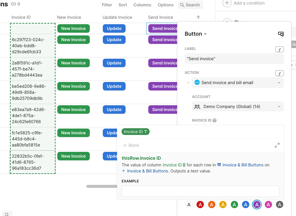

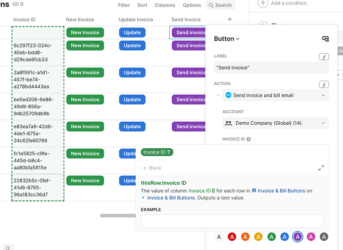

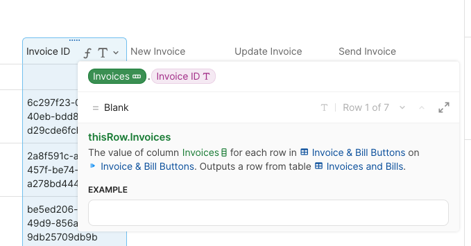

Hey Amir! Have you thought about pulling in the Invoice ID into a column in this table, and then having the button reference the Invoice ID column per row? That would look like this:
Screen Shot 2023-01-03 at 4.47.05 PM
Then in your Send Invoice button, you could point the Invoice ID parameter to the Invoice ID column like this:
Which would then pull the specific Invoice ID for that row. Does that help accomplish what you’re aiming for? Let us know! If not, we can explore some other options :smile:
