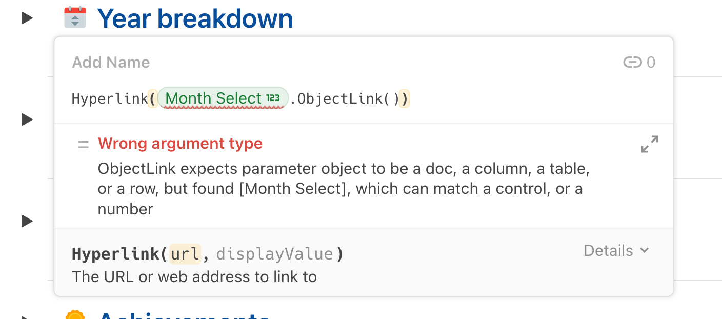

I actually came across the exact same problem as you about ten minutes ago - It wasn’t fixed for me. But I did solve it via the objectLink() formula I was talking about AND it actually does bring over the icon

Just to wrap it up and leave no room for confusion, there are a couple of ways to do this:
I leave a doc with a bit more info on how to do this, so you can check for yourself how it would work:
Thanks! Lots of super useful resources.
Last thing to add - if you use the objectLink method and the object you are referencing is a control on the page (as opposed to a table) that is the first thing on the page, it actually ends up pulling the page name with icon
Ohhh that’s good to know! I’ll add it to the doc!
