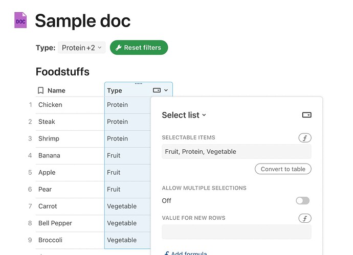

Let’s say I have a table of foods, and each food can be assigned a Type like protein, vegetable, or fruit.
The first thing I’ll do is make sure my Type column is a select list, so that the only values in it can be the types I indicate above.
After clicking “New,” I’ll let the Coda magic pre-fill the selectable items based on what I have in the table already. (I could also type in new values, or use a table, but for simple use cases, I like this way.)
Why do I want a select list? Partly for data validation, and partly to have the type of control I want to filter my data.

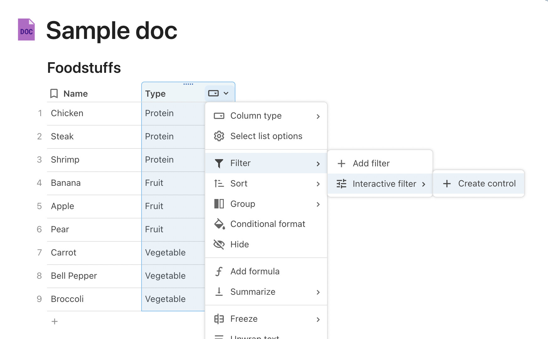

So, next I’ll create an interactive filter on my Type column to allow me to filter based on selectable types of food:
By default, this will give me a select list control above my table. You can always click and drag it to a new location if desired, but above the table tends to be a convenient spot for it!
