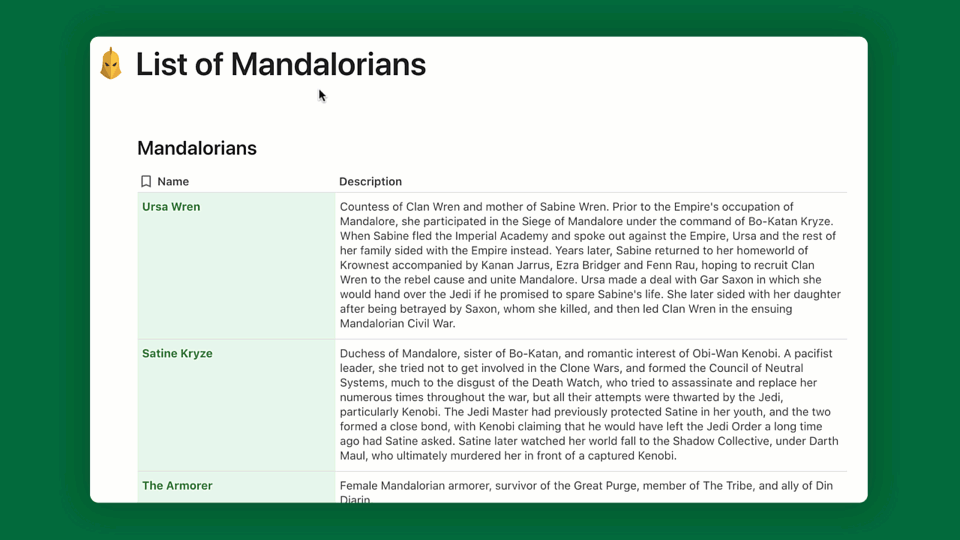

We’ve seen some pretty creative ways to build table search in Coda, but now it’s as simple as adding an interactive filter to any text column. Once added, you can name the control, edit the placeholder text, and choose a unique icon as well.
If your primary goal is to use the text input control to search a table, you can do so from any text column:
- Click the column header
- Select “Filter” > “Interactive Filter” > “+ Create control”
- Your text input control will automatically be placed above your table; right click it to edit any details or settings

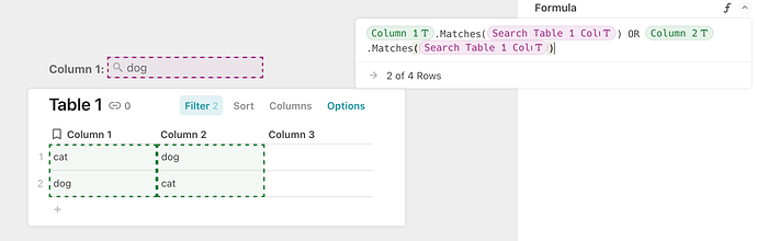

If you prefer to write a custom formula to filter a table for your text input control, follow these steps:
- Hover over your table to expose "Options” in the upper right corner
- Select “Filter” from the table options menu
- From the filter configuration panel, click "+ Add Filter”
- Select “Formula”
- Use the
Matches()formula to set-up search for your table
For example, for the tables in the post, the formula is =thisRow.Name.matches(MandoSearch) where Name is the name of the column I’m searching, and MandoSearch is the name of my text input control. If you’d like to search multiple columns from the same control, remember that you can use OR in your formulas to build out your logic.
