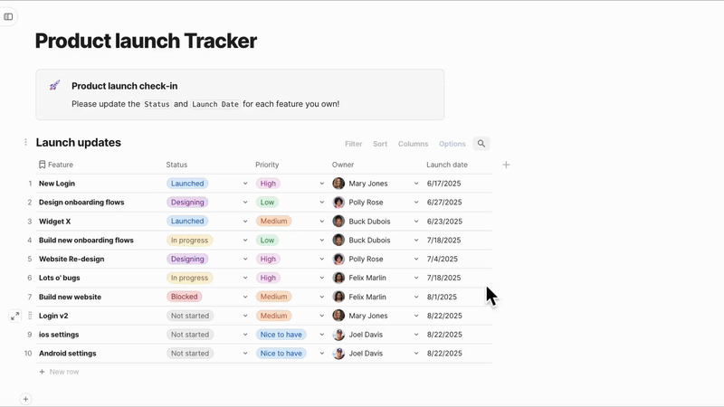

With Table Locking, makers can lock a table once, and have that locking respected across all connected views. Locking a table prevents structural changes, like deleting or modifying columns, and gives makers freedom to apply granular controls over who can add, edit, or delete row data.
As a collaborator, you’ll now have clear visual cues and guardrails, so you can view or contribute to tables without accidentally making unintentional changes.
TableLocking

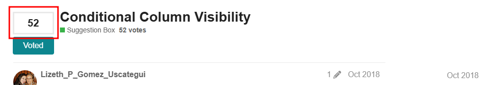

Thanks to @Harshita_Yerramreddy1 for sharing potential scenarios. There are not very often needed but I have few cases when that would be useful.
Hope this is just the start towards the much higher priorities :wink:
