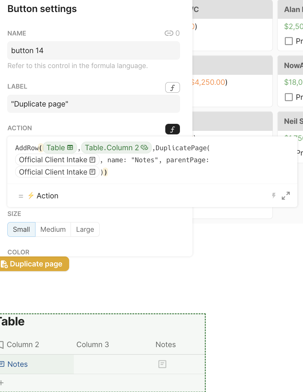

For the third parameter - populate the column value with the duplicatePage() action. Like this!

hi @Scott_Collier-Weir , I just tried to follow this logic while using the step logica provided by Coda, but the function DuplicatePage() did not show up. Only when you move to the formula editor you have access to this function, see below. That is a bit strange, isn’t it?
anyway, once you know this, it works as expected
cheers, christiaan
True,
Action formulas are only available inside buttons. My guess is that we intutively think that the value-setting in the dialog you showed above is inside a button, Coda is not recognizing it as such.
So yes, one will need to open the formula editor of the button and write the whole formula as opposed to using the drop-down options for the button
Good call out @Christiaan_Huizer !
Thank you! This worked like a charm! :smiley:
