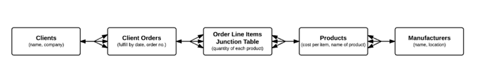

Dear @Thomas_Meissner,
If I understand your question well you will need a “junction” table as in the sample below.
In the same way to connect your “support agents” to the “pending support tickets” the “teams / users” issuing the tickets
I recommend to have also a look to this article: https://help.coda.io/organizing-your-doc/setup-best-practices/schema-design-principles :bulb:
It will help you to understand the relations, like “One to One”, “One to Many” and “Many to One”.
Give it a shot and In case of need, I will try to assist :handshake:
