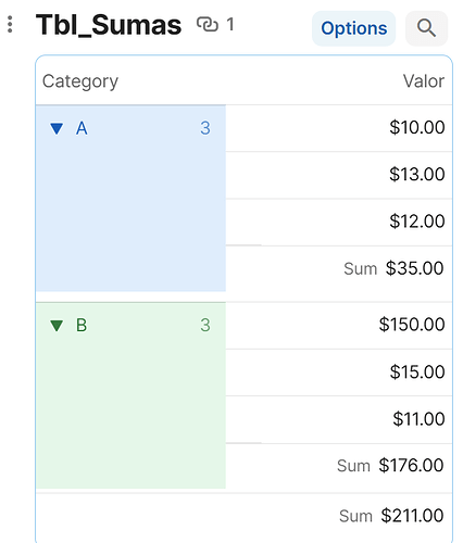

I have this simple data table (1st table in the image)
And I would like to summarize the $ by Category (ideally through a View of the 1st table)
but the result I am being able to achieve is the 2nd table in the image

Hi! I don’t know if you are looking for something like this but you can summarize a column.
I recreated a table like you did and a view where I added the summary
Here’s how you can add that option.

Thank you so much! Was missing the summarize option on the right button…
Is there a way to just state the total sum per category?
without showing the list of items that are being summarized?
Showing the subtotals without details: sure you can. If you share a dummy doc we will show you how. The simplest way is to collapse your summary rows, but a simple formula will give you a report like result.
