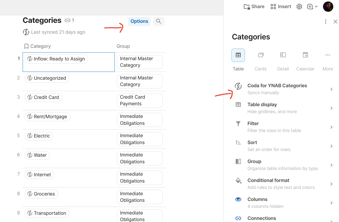

I have 3 different budgets, though, and I can’t seem to connect them… I figured I would have to have 1 Coda doc per budget and create 3 different YNAB connections to choose a different budget in each connection, but it always connects to the same budget. Is it possible to connect to multiple budgets?
You should be able to select a non-default budget in the sync table settings
You can find the sync table settings under the table’s “Options”:
And you should see “Budget ID” as an option which should autocomplete if you type in a budget name:
Got it, thank you so much!
