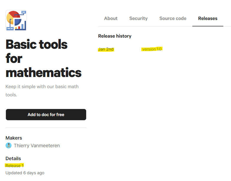

@Thierryvm have you released a new version?
Hello @Leandro_Zubrezki
I have indeed improved my code several times and therefore added formulas.
I have thus de published the pack update and then published again.
So, once published, I checked that the description was well changed and it was indeed the case, but not for the display of the formulas in the list below.
I also did a search for my pack and there bad surprise, it does not appear in the list of proposed packs.
Sincerely yours,
Thierry
Hi @Thierryvm - As @Leandro_Zubrezki mentioned, it sounds like the issue is that you haven’t released your new code. If you look at the listing page for your Pack, it shows that it’s still using the initial release:
When making a Pack there are three main actions:
- Build - This compiles your code and generates a new version (like a checkpoint). The Pack maker can install any version in their docs. This needs to be done every time you make a change.
- Release - This takes an existing version of the Pack and makes it available for other users to use. If you are not the Pack maker you can only install a released version in your doc. This needs to be done every time you are happy with your changes and want to share them with your users.
- Share / Publish - This controls who can use your Pack. Publishing is really just sharing “Can use” with the everyone. You only need to publish the Pack once.
To include the new formulas in your Pack, create a new release from your most recent version. More information on releasing and publishing is available in the help center:

Hey there!
There’s also been a logged bug where if you search for your pack directly (aka the name of the pack) it doesn’t always show up
This could also be at play!
When you make a new release it should be reflected in the Pack listing page immediately, and roll out to documents that use it within a few minutes.
