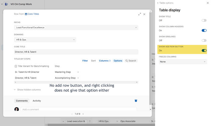

I have a related table showing in a layout. Both the current table and lookup table are unlocked. But for some reason the ‘add row’ button to add more values to the related table is not showing. See screenshot below.
What am I missing?

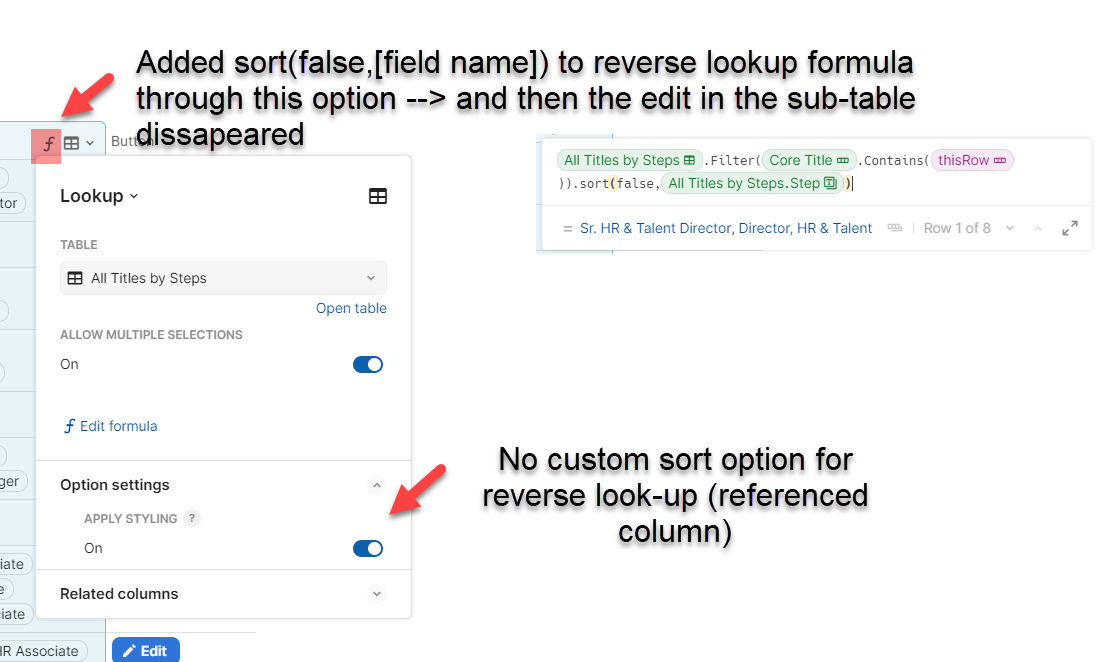

So it is a lookup column BUT I applied a formula based sort to it (sort by x field) and then the add row option dissapeared.
Is there a way around this? Where I could have it sorted but then editable in the popout layout window?

This was so helpful @Pch
So…it’s a reverse lookup column (aka refernced by), and looks like those don’t have the custom sort option built it. See screenshot below:

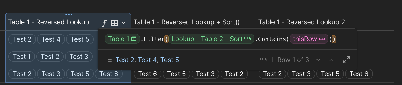

: Even though I really wouldn’t rely on that specific “lookup as a subtable behaviour” to modify datas (it’s feels too “magical” for me) I think that instead of using Sort() you could sort directly the resulting subtable in your expanded row ![]()
In the sample you’ll find below, you’ll see once again a detail view of a table ([Table 2]) with 3 reversed lookups displayed as subtables …
The first one is unsorted and the formula is :
[Table 1].Filter([Lookup - Table 2 - Sorted by Sort 2].Contains(thisRow))
The second one is sorted using Sort() and the formula is :
[Table 1].Filter(
).Sort(false,[Table 1].Name)
And the third one is sorted in the same way I sorted the second one but using this time the “sort setting” of the subtable
. (So the formula for this reversed lookup is the same as the one used for the first reversed lookup)
In that case, the select/add option still appears
Hope this helps ![]()
